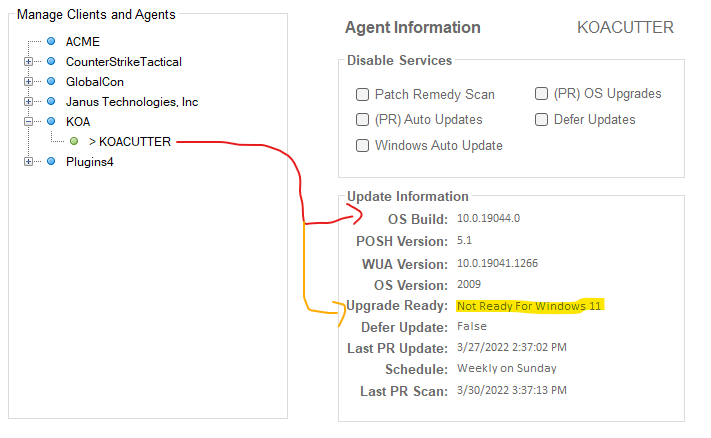

If you look in the Patch Remedy under that agent what does the "Windows 11 Prep value say"
Here is an example of one of my win32 systems on Windows 10 but will never see Windows 11

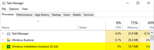

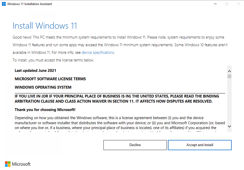

When I run the Win11Upgrade.exe manually (just by douple clicking), it ask me to click on "Accept and Install" if I accept it starts downloading and if don't accept it, Windows Installation Assistant (32 bit) stays in the task manager and dont do it.
Task Manager.png (50.53 KiB) Viewed 12164 times
Windows 11 Accept and Install POPup .png (158.93 KiB) Viewed 12164 times
I believe when we schedule via Patch Remedy, it stuck at the same page and not able to perform auto "Accept and Install"

This seems to be a pretty common issue where you can't do a silent upgrade of windows 11. The EULA seems to always need user input even with the command switches /quiet /eula accept.
Not sure if anyone else has found a way around this?

For Windows 11 upgrades we deploy a POSH script that does the basics to environment to get upgrade rolling, download the update and execute it with the following agrs.
/auto upgrade /quiet /eula accept /Compat ignorewarning /copylogs $LogDir
There are several more switches we could send but the Microsoft docs show that this should be sufficient to roll without EULA popup stopping the upgrade.

From everything we tried the "/eula accept" just doesn't work. We have had to go back and manually upgrade to win 11 from 10 due to this.
