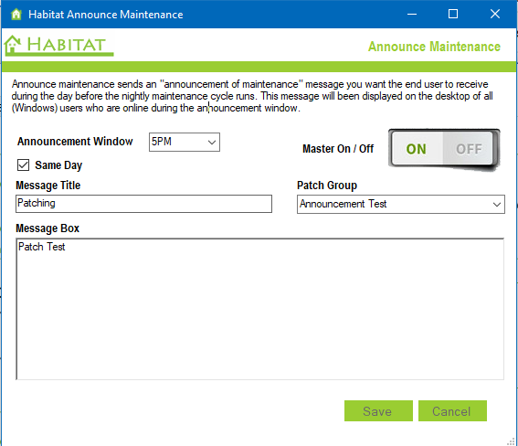

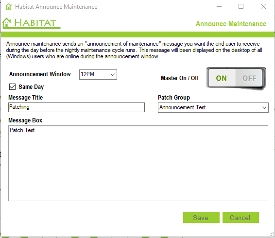

Hello,
I am attempting to use the Habitat Announce Maintenance tool to announce patching to users but it doesn't seem to be working. When I try to set a certain time and save, it reverts back to 12PM as the selected. Also, when I set a group and save it still doesn't send out notifications even at 12PM. Any help would be greatly appreciated.
Thanks!

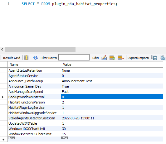

That's odd, I am testing mine here and I am updating as expected. Let me reform the statement a little to see if maybe your not interpreting the field correctly. I'll put this out in 1.0.1.22 in the next couple of days.
Also test for me that your setting the same-day and patch group setting in habitat properties
SELECT * FROM plugin_p4a_habitat_properties;
This should give a true or false for Announce_Same_Day and the Patch Group Name for the Announce_PatcGroup field
It will also have the URL fix in it for POSH maintenance.

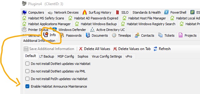

These will be the ID's that the messaging script will execute against when the correct time and date arrive. If the computer IDs are not in this list then verify they belong to group by viewing group, verify they are online and verify that the client's extra data field is set correctly for Announce Maintenance (Enable Habitat Announce Maintenance), see image below.
