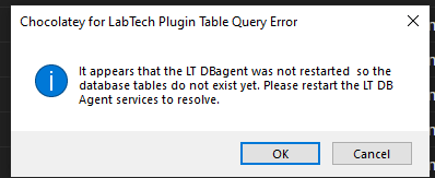

So, from what I understand Chocolatey for Labtech should work with my Automate. Then in that case I have an issue using it. I restarted the server, database agent but when I try to open it I get an error message( see attached file).
How I can fix this ?

You said you rebooted the Automate Server? Or did you restart the Control Center Console? When the Labtech/Automate DBagent is restarted, it is instructed to do the following as seen below. It shows tables to see if table exists, if not it creates them. Make sure a Restart of the DBagent has successfully happened.
This error appears when the following query fails.
SELECT * FROM `plugin_sw_chocolateyii_approved_apps`
To see if table exists
SHOW TABLES LIKE 'plugin_sw_chocolateyii_approved_apps';
To create the table we execute in SQL
CREATE TABLE `plugin_sw_chocolateyii_approved_apps` (  `id` int(11) NOT NULL AUTO_INCREMENT,  `Application` varchar(245) NOT NULL,  `AppCMD` varchar(245) DEFAULT NULL,  `Image` mediumblob,  `Source` varchar(255) DEFAULT NULL,  `SourceName` varchar(255) DEFAULT NULL,  `SourceUser` varchar(64) DEFAULT NULL,  `SourcePass` varchar(145) DEFAULT NULL, `AsAdmin` INT(2) NOT NULL DEFAULT 0,  PRIMARY KEY (`id`)) ENGINE=InnoDB AUTO_INCREMENT=35 DEFAULT CHARSET=utf8;
If table exists try adding an approved application to apps list. See if that works or fails.
Post back your findings here.
If you are hosted then you will need to download a SQL access tool or request from support to validate the table listed above.

The pop up that produces this error value "It appears that the LT DBagent ..." is actually in 3 places. I was under the assumption it was just one place.
So I need you to provide me with 3 screen shots if you would.

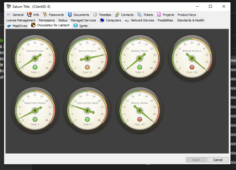

# 1 The Main View, Does pop up happen here?
#Client Console, does the popup show up here when this tab is viewed?
#Agent Console, does the pop up show up here when this tab is viewed?
If you truly had a DB issue then the pop up will show in all 3 areas. If only one of the 3 areas are causing this pop up then we are most likely having a piece of bad data causing a failure in either a loop or data assignments. Something like a non standard char or negative value.

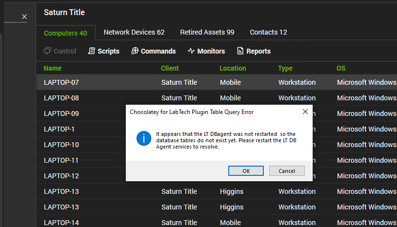

This error only shows up when I open the main console or try to refresh it:
main view.PNG (84.87 KiB) Viewed 30227 times
In the client window there is no reaction :
client console.PNG (329.34 KiB) Viewed 30227 times

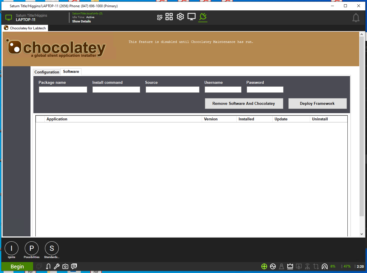

In agent console it's just empty :
agent console.PNG (114.15 KiB) Viewed 30227 times

When you say
You are referring to going to the Tools Menu and launching the Chocolatey Global Management tool. I want to make sure we are on the same page.
The agent page would be accurate if Agent has not deployed Chocolatey yet.
