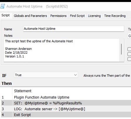

The Plugin Script Function is called Automate Uptime and can be passed a number (represented in days) to test against uptime. If the uptime exceeds the value provided it will force a reboot of the automate host.
Here is how we would use script function.
Create a new script. something like the script we have below.
Set The script function parameter1 to the number of days the Automate host is allowed to be up before a reboot is executed.
Now execute the script once on any (1 )agent and see the script log output to see you Automat Hosts uptime and OS type.
You might find your Automate host is still on Windows server 2012 and hasn't rebooted in months.
