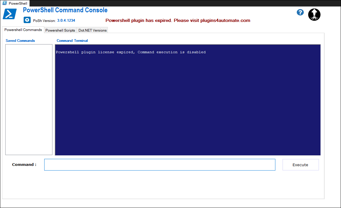

Powershell plugin has expired
Posted: Wed Jul 14, 2021 7:24 pm
by mrwlms4586

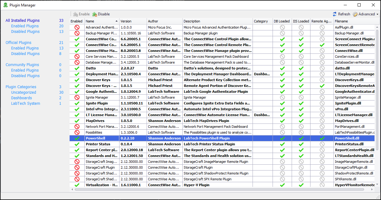

I downloaded and installed the latest plugin
Restarted DB agent
Removed and re-added powershell plugin
Thanks in advance!

We show a valid license for "pitc" and last access was on 2021-08-02 07:00:05 which typically at this time is automation running so the Automate host is checking license for validity successfully.
Can you confirm this is an issue with your Control center still and if so please select the Squid icon in right corner to reveal the version it thinks its on from your Control centers point of view.
If versions do not match then you should delete the DLL from the local tech PC with the control center on it and relaunch the control center so it can refresh DLL from Automate host.
See if that has any bearing on issue.
