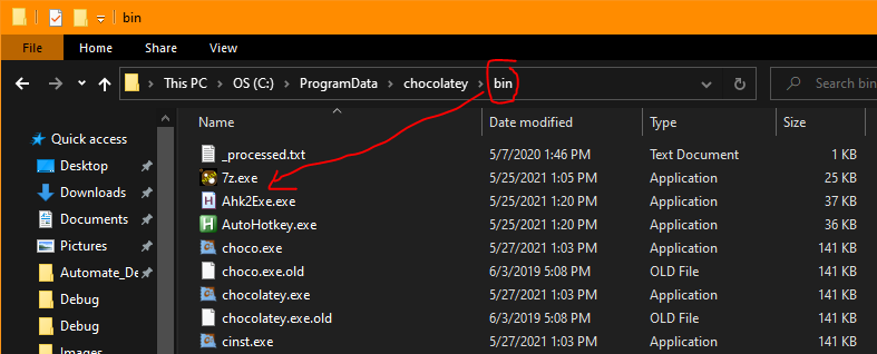

I will be happy to put in a test like this, might need to link it to a on / off switch so you can chooses whether or not it removes directory. There could be things in that directory that may be blown away that shouldn't be. Like in the BIN directory it likes to store portable apps.
See image, 7Zip is there along with several others I have on my install list. By blowing away this root directory the end user will loose those files as well. So adding a control that will toggle this feature on and off would be in the interest of the MSP.

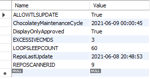

We have added in a new control variable to assist in setting the Excessive Running Commands test when running automation to do framework installs, App installs and App update. To view the properties for C4A run the following SQL
SELECT * FROM plugin_p4l_chocolatey_properties;
Should Produce the following:
The setting is called EXCESSIVECMDS with a default value of 3. To adjust value run the following SQL command
REPLACE INTO plugin_p4l_chocolatey_properties(`Name`,`Value`) Values('EXCESSIVECMDS','5');
