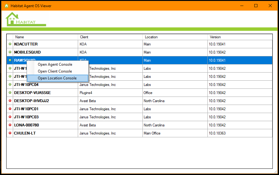

Clicking any chart will launch viewer where you have menu options to manage the Client, Location or Agent directly.
OS Types Viewer

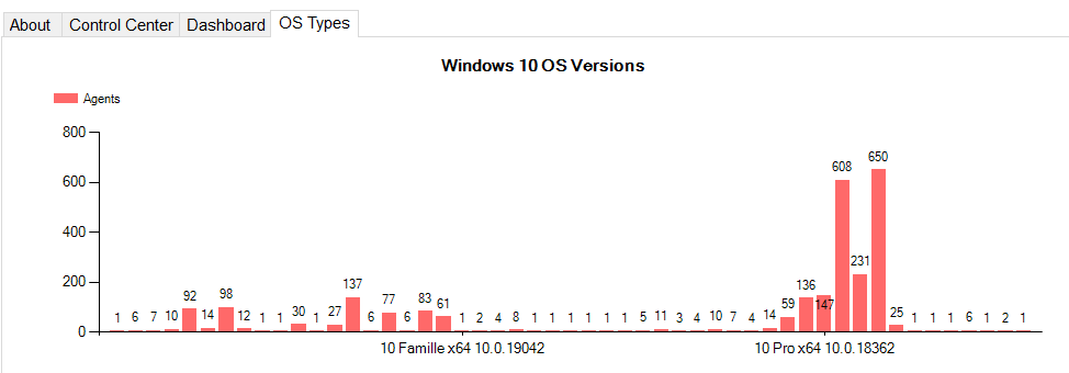

I think you may need to rethink this for larger MSPs:
2021-06-07 15_12_15-Window.png (11.99 KiB) Viewed 30647 times
Only two of the bars ended up getting named.
If you can do a mouseover tooltip over each bar, or some other identification, that would probably be helpful, since trying to fit in 30 labels is a bit ridiculous.
(Or only show bars that have at least 2 systems in it, and lump the rest in "other")
Are these sorted? (ie, oldest on the left, newest on the right?)

I think this view kind of makes my point for this tool. From my review I am seeing (51) different versions of Windows 10 across your environment. The tool is pointing out how many agents that have some updates paths available to them.
This is where the WIndows Upgrade Assistant tool should come into play. Maybe look at adding a means to select all agent under a given chart bar and assign a upgrade policy and schedule to them.

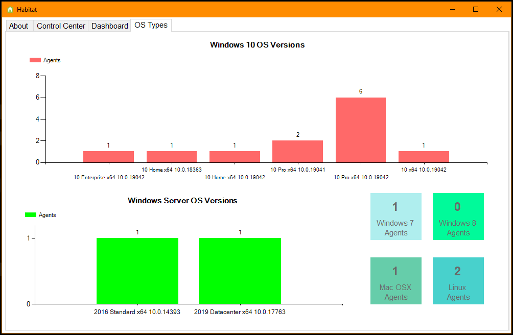

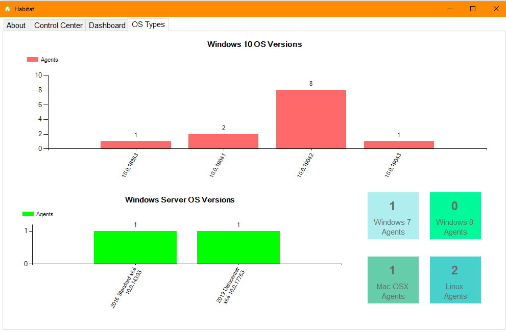

We have now updated this chart as follows.
We have removed the Windows 10 OS type and now show just the Version number and have limited this view to using a global properties value in the Habitat database called "Windows10OSChartLimit". By default it is set to 30 but you can change this as desired to control the view of this chart.
The same limiting was done for Windows Server chart. The properties value is "WindowsServerOSChartLimit" and defaaults to 15. You can modify this value to your needs.
We also changed the angle of the legend to allow more readability from the data.
This is now in Habitat 1.0.0.77 due out today in the automated updates.

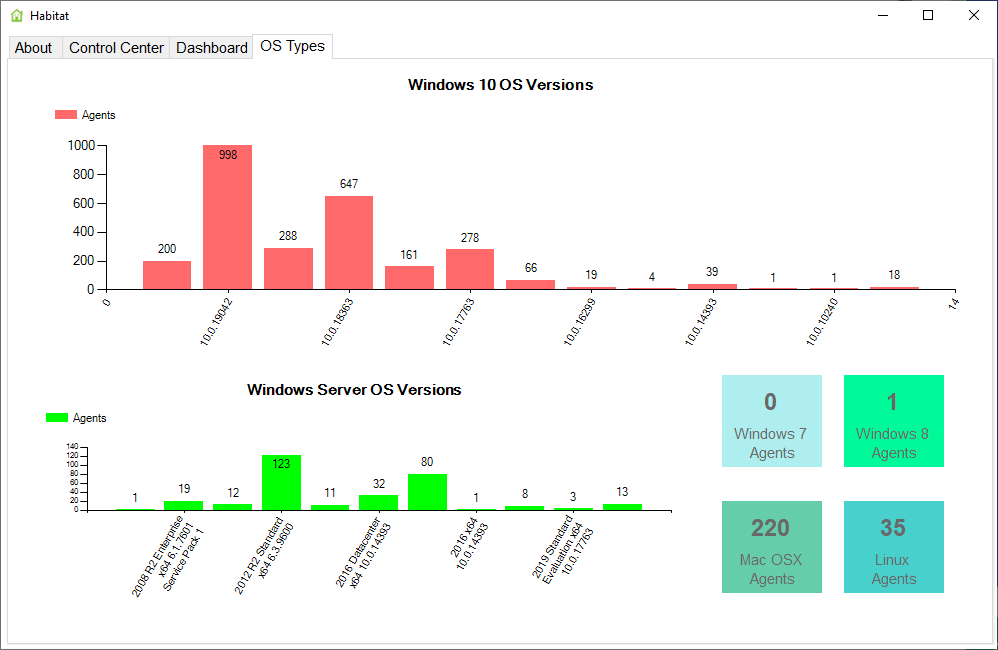

Here's the full view with Servers as you asked about:
2021-07-09 11_04_53-Window.png (29.86 KiB) Viewed 30127 times
Looks like they are sorted, so the 200 bar on the left is 19043/21H1.
Maximizing the window to full screen does not add more chart labels (just makes the bars really really big). And the scaling is kind of weird. The bottom half (Servers, and non-Win10 boxes) stays the same size (the Server OS bar gets stretched wide, but not up, the four squares stay the exact same size (number of pixels))
We have a bunch (+- 80) of Windows 7, but the box is saying 0. So not sure what the detection method there is, but it's not working for us. (The one Win8 is correct).
We also have a dozen Microsoft Windows Embedded Standard x64 (6.1.7601 Service Pack 1) (So that technically counts as Win7 maybe?)
If you want a thorough critique, here's some other observations:
The 0 and 14 on the X axis are not relevant. Not sure if those can be hidden.
The unlabeled columns are unidentifiable. If we can have a mouseover tooltip with the version that would be great, or more X-axis labels. The way I identify them now is to click on the graph to get to the table data, then sort on the OS version and scroll till I find what's there.
