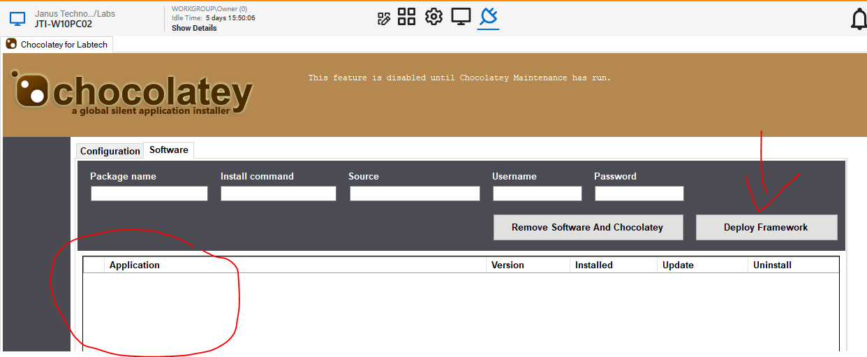

when adding computer to choclatey we always see the message: This feature is disabled until chocolatey maintenace has run.
We reduced the maintenance to run every hour, but it´s still teh same.
How can we fix this?

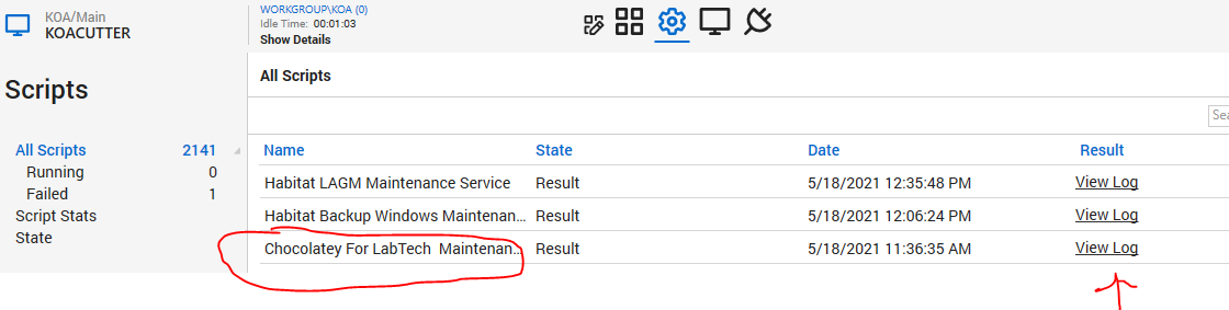

I get:
Chocolatey EXE not found- Install failed

In the Scripts I see

That´s what I see in commands:
