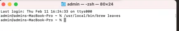

Running on Mac terminal:
Running %2fusr%2flocal%2fbin%2fbrew+leaves+%7c+awk+%27%7b+print+%22(1007%2c%7c%7c%22+%241+%22%7c%7c)%2c%22%7d%27 gives and error " Command not found"
Running /usr/local/bin/brew leaves see picture below
HBrew-Running on Mac Terminal.png (29.7 KiB) Viewed 7058 times
Running on Automate:
I first run %2fusr%2flocal%2fbin%2fbrew+leaves+%7c+awk+%27%7b+print+%22(1007%2c%7c%7c%22+%241+%22%7c%7c)%2c%22%7d%27
and then
HBrew-Running on Automate.png (10.76 KiB) Viewed 7058 times
Let me know if you need more info and thank you for the quick response!!
