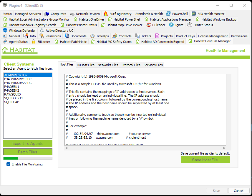

Client View
Allows you to construct or fetch and save Windows networking files as a clients default then using the Enable File Monitor you can monitor the agents under that client for differing files, files that do not match the client default..
Export To Agents
This control pushes a copy of the Clients Default Files to the agents table so that the agent default will be the same as the client default. This is used when Enabling File monitoring so that the agents can get a copy of a client default is needed. You can modify and save the agent files at the agent console and the monitor will test against the modified files.

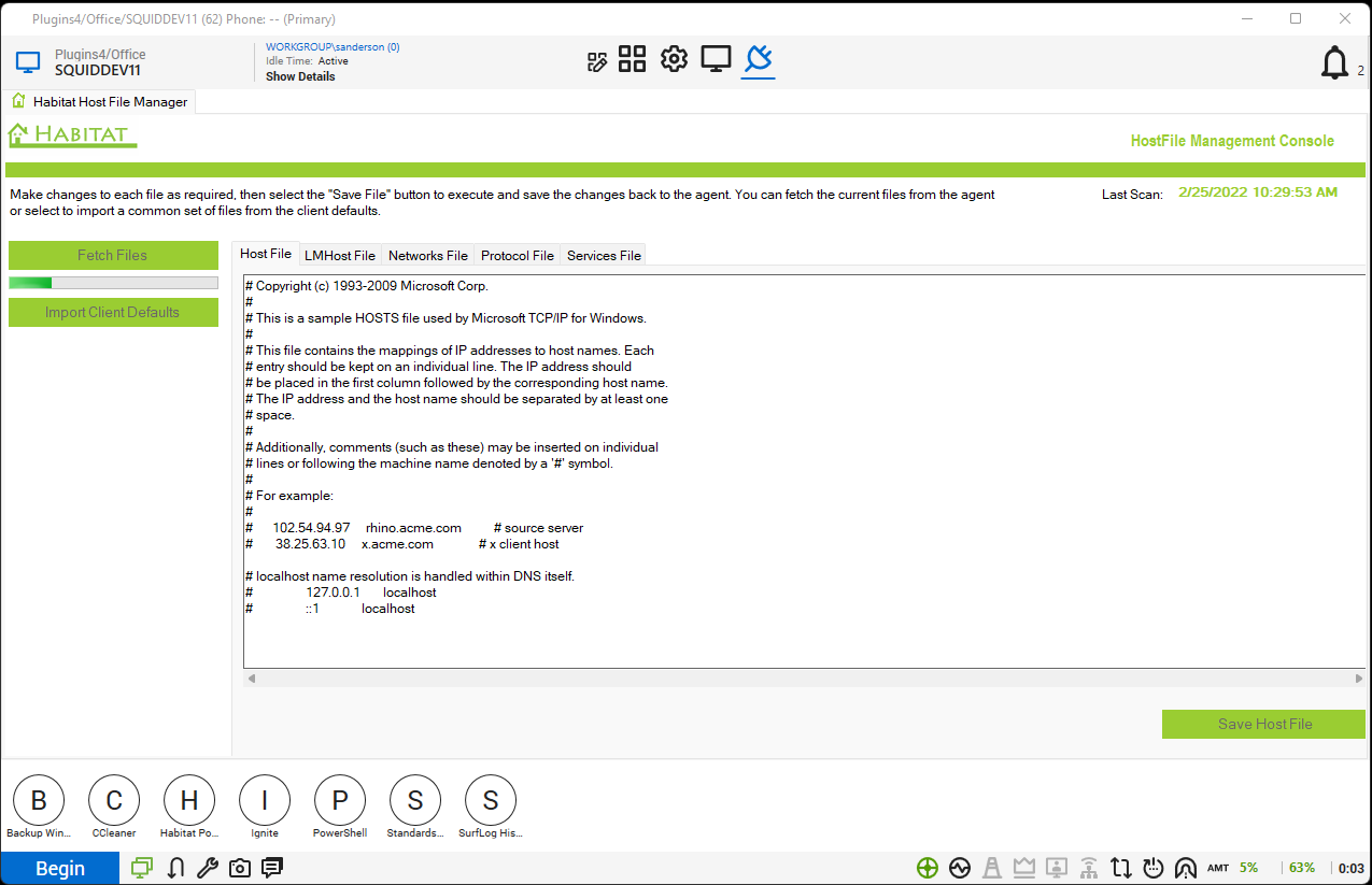

Agent View
Allows you to grab the current files, modify them and save them back to agent along with Automate database.

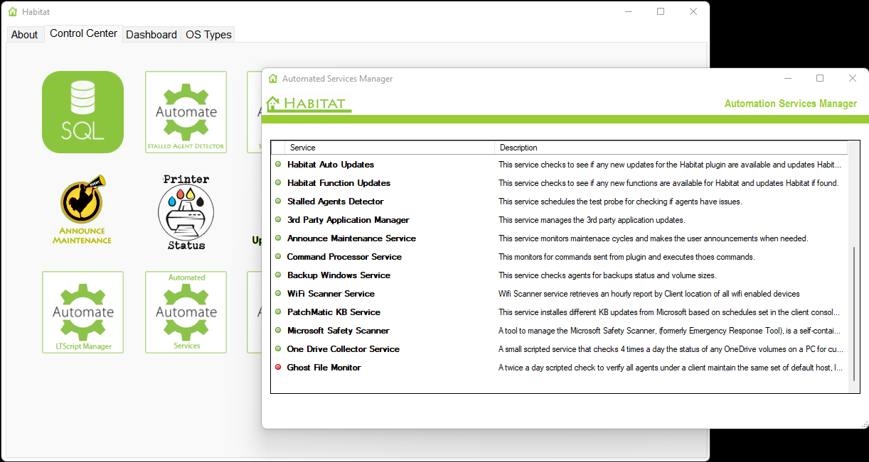

Enable File Monitor

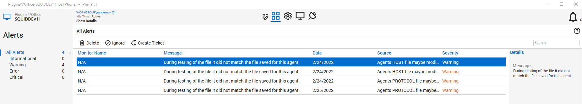

This is an automated service that tests the agents under a client for network files that differ from the agents defaults. To allow this service to operate you will need to enable this service in the Automate Tasks inside Habitat. If an agent is found in noncompliance a warning alarm is set for that agent.
Alarms will show up as warnings and will tell you which file is noncompliant.
Enable the Automated Service

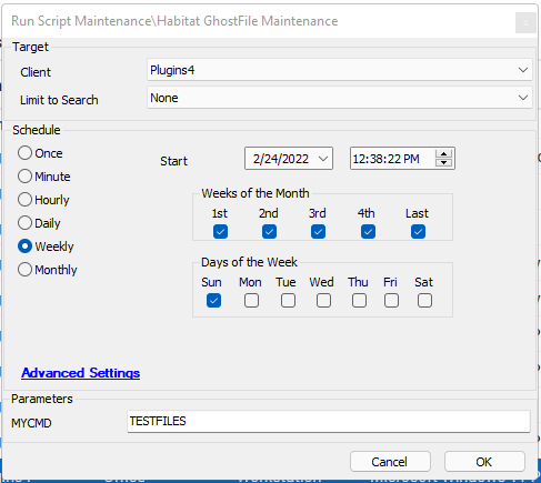

We fixed a minor issue with loss of newlines when saving and we also added to Habitat GhostFile maintenance script the ability to manually schedule a file testing scan. You will need to use the built in script scheduler for Automate and select either a client or an agent to apply schedule to.
The TESTFILES command launches a script function that will read in all current files from agent and compare them to the files stored in database for the same agent. if a match then nothing happens, if the files do not match an LTserver Alert is launched for that agent.
