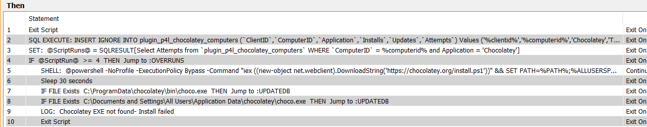

The Script executes the commands as shown, waits 30 seconds for completion then tests the 2 locations to see if it can see the Choco EXE.
So first we need to see what the return was from the install POSH command was in the agents script logs then see / verify if the choco EXE exists anywhere on agent. It may have placed it else where, which would cause failure from file check.

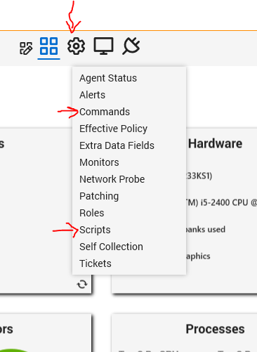

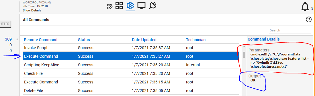

I failed to mention it but can I also get the command log entry for the same time period?
The log I am most interested in is the Executing log entry for the powershell cmd being run to install Chocolatey.
It should look like this although in this example the command is to Chocolatey features scan but the log type is the same. We need to see what the agent returned when the install command was executed.

Everything inside the Execute command is preformed by POSH being executed. Our command just sends POSH the URL to start the process.
Something is preventing the download of the choco zip file. It sees the URL and tries but fails to save file from what it looks like as when it tries to unzip it its not there.
So either AV is locking and removing the file or possible permissions issue with whom the agents LTsvc runs as or it truly could not get download from URL.

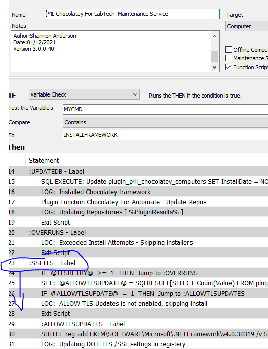

What I can do is make a test for this error and if positive it adds the regkey and retries install commands again.
That way it only goes out to agents that show the issue and not blanket all agents with changes.
I should probably add a switch the "enables" this setting so you have an override to this feature incase you want to opt out.
Re: Chocolatey Failing to deploy
Posted: Tue Jan 12, 2021 9:05 pm
Ok we are updating to 3.0.0.40
Inside is several little changes.

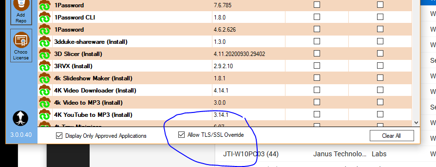

Under the global manager tool there is a new check box to allow override of the TLS/SSL fix.
Then if the script fails with file not found it will attempt a TLS correction in registry if the previous checkbox is selected.
After the fix is applied it will reattempt a chocolatey install one more time during script run.
