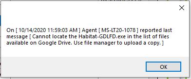

I followed your post to set up the Google Drive integration and it detects my files on Google Drive, but when I click "Add File Assistant", it generates an error, then states that the upload was complete. When I refresh the file list, it appears as an untitled and invalid file. Confirmed it's the same directly on Google Drive.
See attached screen captures. Is there a place I can manually download Habitat-GDLFD.exe from so I can drop it into my Google Drive without using the Add File Assistant button in the plugin?

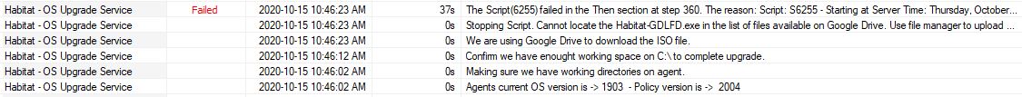

The problem I'm having is with deployment. If I trigger a deployment to a computer, this is what I'm seeing in the script logs:
This is the log for the failed script at the top of that list:
The Script(6255) failed in the Then section at step 360. The reason:

The reason I thought I needed Habitat-GDLFD.exe is because the script failed with the error that it could not detect that file:
L359 Script Log MessageMessage (P1): 'Stopping Script. Cannot locate the Habitat-GDLFD.exe in the list of files available on Goo...' T: 36.8478039
If that's not the problem, can you provide any information as to how I can get this working?
