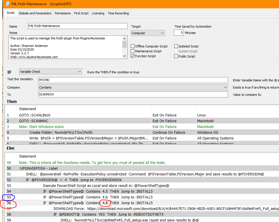

I keep getting into this loop where i try to update powershell on some of my machines, I see in Powershell manager that .net4.5 is installed however it keeps looping me back to the error that .net is not installed and tries to install it but never verifies properly that it's installed and therefore we can not update powershell on any machines. I have updated to the latest version and still see this issue.

Which plugin are you in? Powershell manager or Habitat? Both have this tool in it.
Can you send us some logs / screenshots of what your seeing?

powershell manager.
log says
Powershell update to 4 has been stopped due to DotNet Version not at least at 4.5, Installing dot.NET 4.5 now, you will need to reboot or allow reboot and then try again to install powershell 4 after 4.5 is installed.
this device has been rebooted as well with the same results
i am not sure but is your search not looking for .net4.8
Re: Powershell Manager
Posted: Mon Aug 17, 2020 2:15 pm
Yeap, its look no higher than 4.6 so that is an issue. here is how to fix the issue quickly.
Open script and edit the else section at line 55. Copy line 55 and save as line 56, edit line 56 to now reflect 4.8 as the value.
Posted: Tue Aug 18, 2020 6:52 pm
by ccalverley
I also added another line for .net 4.7
Thanks for pointing me in the right direction, tested it and it works now
