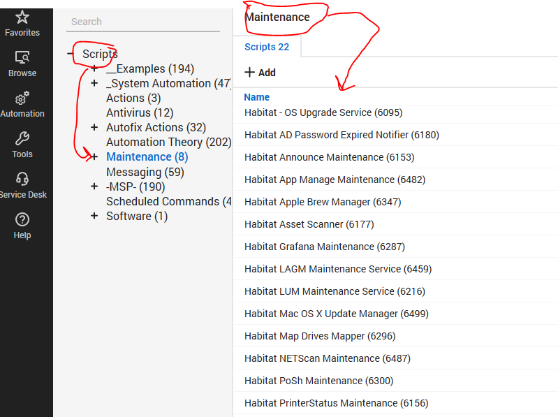

Can you confirm the following scripts are present?

by michaeldiaz
Yes they are here:
