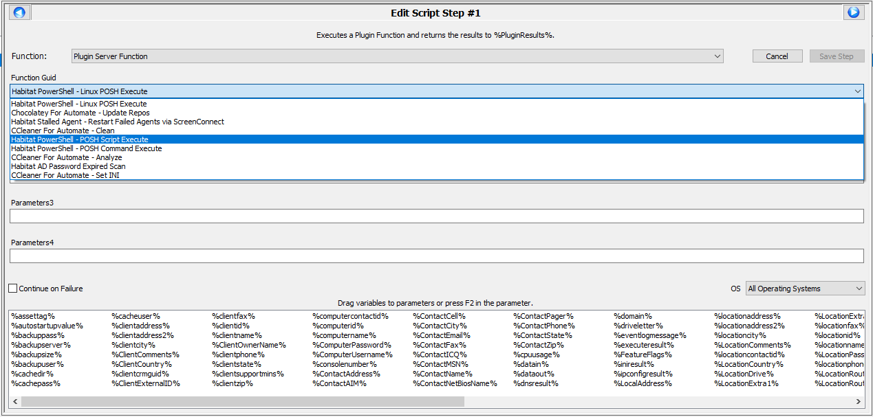

Habitat is placing new Automate Scripting Functions into the script editor for MSPs to use as needed.
Here is the current list of available functions and the parameters you need/can pass to it.
  • Habitat Powershell - Linux POSH Execute (Param-1= %computerid%, Param-2= Powershell command to execute)
  • Habitat Powershell - POSH Command Execute (Param-1= %computerid%, Param-2= Saved Powershell Command Name to execute)
  • Habitat Powershell - POSH Script Execute (Param-1= %computerid%, Param-2= Saved Powershell Script Name to execute, Param-3={optional}extra parameters to pass to script)
  • Habitat Stalled Agent - Restart Failed Agents via ScreenConnect (Param-1= %computerid%)
The POSH Command and POSH Script functions do not take commands and scripts directly, you must use the Habitat Powershell tool to save the scripts and commands to Automate first then pass to the function the friendly name you gave command or script.

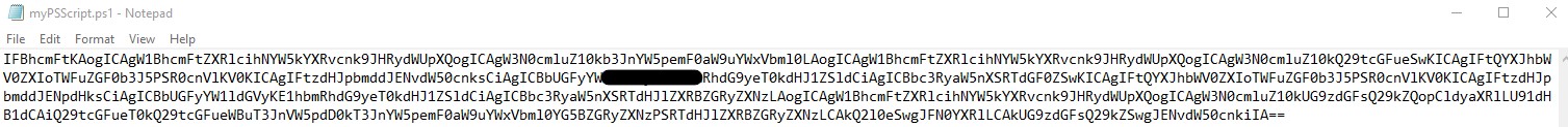

Seems that the Plugin Server Function for running the PowerShell scripts isn't working properly now. Running the script with the Plugin on the Computer Management Screen works fine. It grabs the script from the DB, decodes it, writes it to a file, and then runs it with the parameters. However, when using the Plugin Server Function, it grabs the base64 from the database, and writes that to "myPSScript.ps1" instead of the script itself.

edward.cossett wrote: Fri Jul 03, 2020 3:24 pm Seems that the Plugin Server Function for running the PowerShell scripts isn't working properly now. Running the script with the Plugin on the Computer Management Screen works fine. It grabs the script from the DB, decodes it, writes it to a file, and then runs it with the parameters. However, when using the Plugin Server Function, it grabs the base64 from the database, and writes that to "myPSScript.ps1" instead of the script itself.
I'm having this same issue, I'd LOVE to get this final piece working. Any progress Cubert?
Re: Habitat Plugin Server Functions
Posted: Thu Feb 04, 2021 2:38 pm
This has now been repaired in Habitat 1.0.0.61 which is due out in todays updates.
