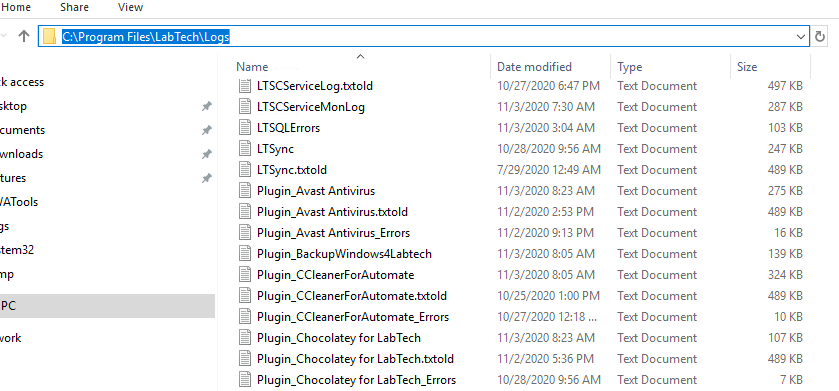

interesting... I do not have a file c:\programdata\labtech\logs\plugin-PrinterStatus.txt in the path or anywhere else on the server.
I also checked several agents and no plugin-PrinterStatus-errors.txt file exists on them ether...
Would this then be a Connectwise support issue ?

I may of gave you a bad location, the LT Host there is a folder at "C:\Program Files\LabTech\Logs"
Inside that folder should be text files and some of these files should start with "LT" and others start with "Plugin"
See if you see one with "PrinterStatus" as a suffix.
Post any files you see there here for review.
