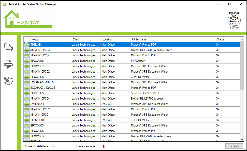

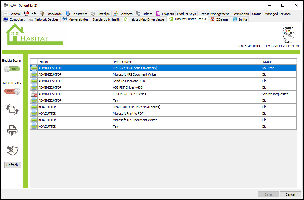

New in Habitat is the improved Printer Status tool. This tool allow you to manage printers in an easy to use format. See the status of all the printers across your environment with ease.
Here is a video review of Printer Status Here
Printer Status Global Viewer sees all printers across all clients at one time.
There are many controls available by selecting a printer from the list and right clicking it for menu options.
Printer Status Client Viewer see all printers client by client
You can exclude printers you do not want to see by using the exclude button at either the Global or Client Views.

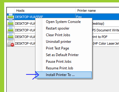

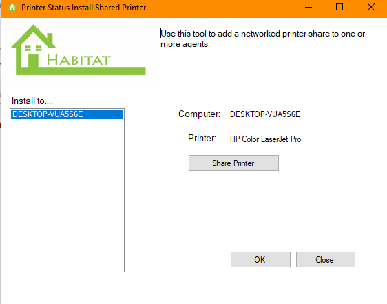

Posted: Fri Jan 08, 2021 6:08 pm
by ccalverley
Suggestion for an enhancement
Add an option on right click, to install the printer on a computer/ computers
ideally
when you right click on a shared printer
(can determine this with powershell Get-Printer command under the shared object)
you see an option to "install this printer"
when selected a box pops up with the printer name autopopulated in a textbox and a list box of all online location workstations which allows for multiselect.
the bottom of the box has two buttons one that says install and one that says cancel
install executes "RUNDLL32 PRINTUI.DLL,PrintUIEntry /ga /z /n"\\computername\printername" on each computer selected.

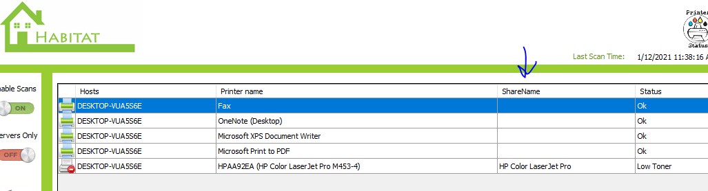

Ok we now added in Habitat 1.0.0.59
Updated scanner to acquire all share names of shared printers
Anew menu to add shared printers
Select 1 or more agents from list and push the shared printer out to them in real time.
Downloads now available and auto update should update tonight.
