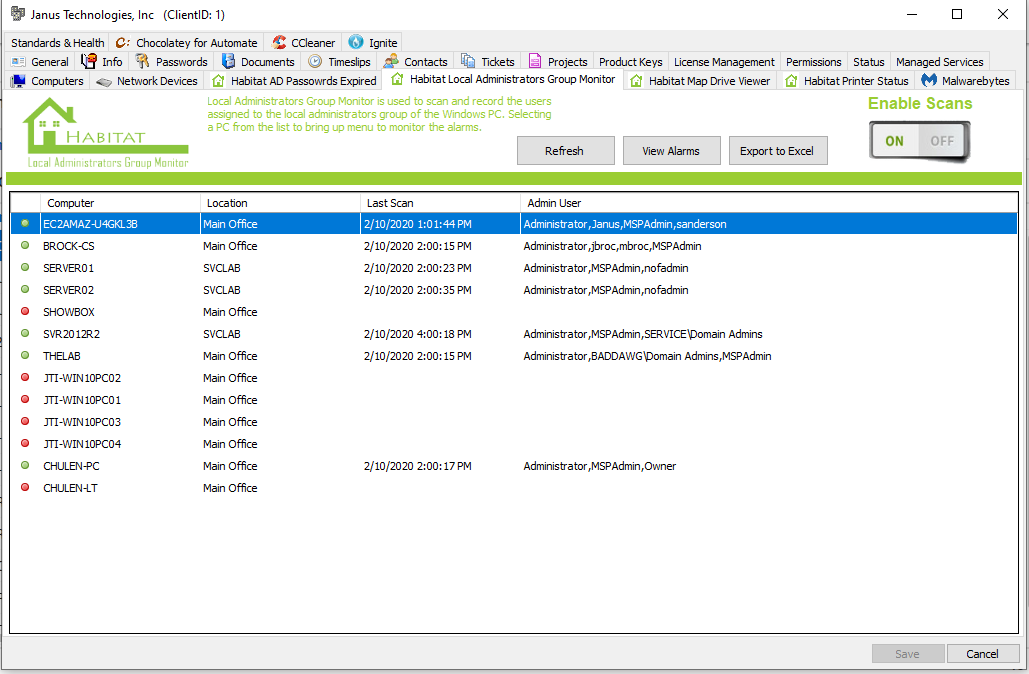

Thanks for your reply. I would implement the new solution shortly (before the end of the week) and advise on how its going. From reviewing the post am i right to think it will show all devices under the tenant even if the device has not been scanned?
In terms of making changes to logged in user accounts would it be the same as admon. eg applying admin rights to users logged into devices?
Thanks in advance
Re: ADMON not collecting comptuers
Posted: Tue Feb 11, 2020 3:16 pm
Correct, here is a view where some agents are offline so have not scanned yet.. They are still listed and if selected and right clicked, a menu will appear to allow a "scan now" so you can force agents to scan and validate the results. Otherwise all online agents get scanned daily.
- LAGM-Missingagents.PNG (65.3 KiB) Viewed 30648 times
