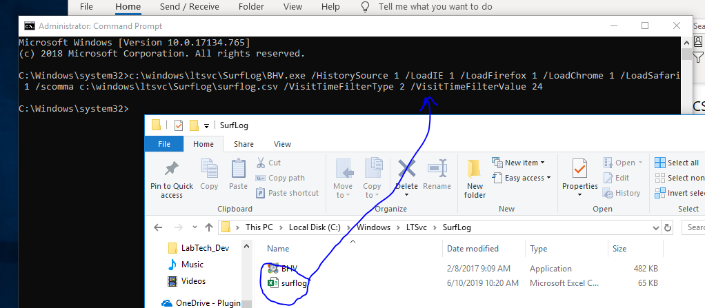

Posted: Mon Jun 10, 2019 2:20 pm
David,

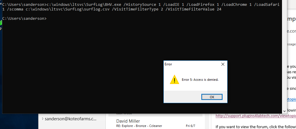

If you copy that entire line... and run it in a command shell
c:\windows\ltsvc\SurfLog\BHV.exe /HistorySource 1 /LoadIE 1 /LoadFirefox 1 /LoadChrome 1 /LoadSafari 1 /scomma c:\windows\ltsvc\SurfLog\surflog.csv /VisitTimeFilterType 2 /VisitTimeFilterValue 24
Do you get this?

If no errors do you now have a surflog.csv file? Try running shell as administrator to see if output changes.

Running from command shell I get the Access is Denied error you indicate in your screenshot and no surflog.csv file is created.
Running from command shell as Administrator I get no error and the surflog.csv file is created but is 1KB and contains no data.
