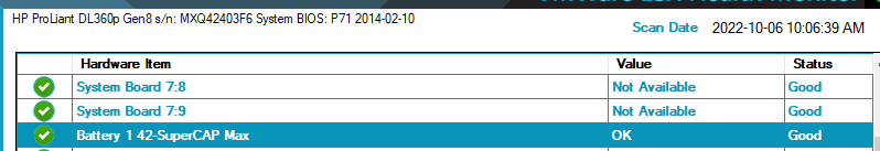

Ok So your showing a battery bad and a raid controller issue.
Lets look at the CIM output and in the data we look for 2 data points that need to be with in the same element.
  • "Element Name =" - Name of hardware item

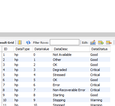

  • "Element Op Status =" - status of hardware item (0 and 2 are considered healthy in all systems but HP also uses 5)
Most hardware follows a common default CIM status code set. HP on the other hand did not. HP used the status of 5 as a "Good" code as well among other differences.
You show a HP ProLiant
Screenshot 2022-10-03 084409.png (15.01 KiB) Viewed 6261464 times
Taking the first of the two error reports you show in your example.
The Battery Bad Issue
The CIM Data returned for that is
20220927 17:23:21 Element Name = Battery 1 42-SuperCAP Max
20220927 17:23:21 sensorType = 2 - Temperature
20220927 17:23:21 BaseUnits = 2
20220927 17:23:21 Scaled by = 0.010000
20220927 17:23:21 Current Reading = 29.000000
20220927 17:23:21 Upper Threshold Critical = 65.000000
20220927 17:23:21 Element Op Status = 2
The element Battery 1 42-SuperCAP Max shows a status of 2 which as for the HP types list is an "OK". Now this is a status of the time of the scan and as such the status of the element may had changed. ESX maybe keeping a cache of or history I'm not aware of. I can't say so you would need to know your hardware and maybe preform some system tests to confirm failures.

SuperCAP Max is not the same as battery status so it looks like there is no CIM data for the battery status so that's the same as for the HP Smart Array P420i Controller : Embedded : HPSA1 Element.
What can be done to make sure the informaiton is showing in the CIM data?
Would that be a bug in ESXi or something on the HP side (i.e. HP driver)?
Thanks,
J.

I've played with the ESXi host settings and found that when I set the vendor to auto I get the battery CIM data and it shows status failed but the ESXi health monitor shows it as okay.
Screenshot 2022-10-13 122024.png (13.4 KiB) Viewed 6261289 times
What can be done to change that?
