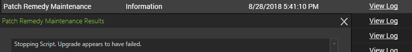

I ran the update Friday before I left, and it stopped 6 hours later with the message "Stopping Script. The Setup.exe file was not available for execution. The downloads or network cache file maybe currupt."

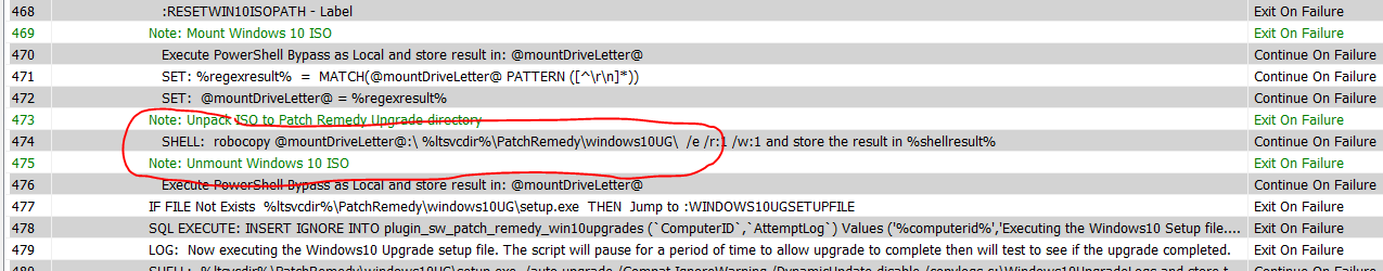

If you look at the Patch Remedy Maintenance script, it shows that we indeed copy the contents of the ISO locally, We can also be set to copy the ISO locally and then copy it out of ISO to local drive. We never run setup from remote share as to many issues could cause a failure during updates.

Thanks for that. I am able to robocopy the ISO from the destination machine, accessing the network share. One of the things I tried was copying the ISO to the destination machine before starting the update, but the script deleted and recreated the destination folder.

I added the SYSTEM user to the permissions of the network folder and am still running into the same availability error "Stopping Script. The Setup.exe file was not available for execution. The downloads or network cache file maybe currupt.". I am able to access the file from other computers. This error is what I get when I don't get "The Windows 10 ISO failed to download to the network share", which also confuses me as the file is available in the network location.

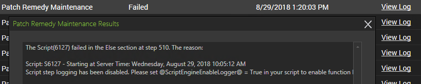

Same things seem to be happening to us. We were having issues with not downloading to network share with access denied or connection interrupted message. However, once we got past the access denied issue, the iso started to transfer over to the network share. But it got timed out or connection interrupted message in the console command section.We are using the URL process. However, since it was a test machine in our network, I just copied the iso to the network share so I can proceed with the process. On two of our machines we attempted the upgrade now option. It goes all smoothly up until the script says 'Windows 10 Updates are now processing on the PC, allow 2 to 4 hours to complete. User may need to log into system to fully complete the updates.” However, I was monitoring the machines. There was not indication that the setup ran besides the task manager showing Windows Installer in the processes. I know in Event Viewer under System, it will show if windows updates are being downloaded or installed. I also had Windows Updates screen open so I can monitor and it had no change. Does the PR setup and script do the upgrade independently or silently that would coincide with this?
After the script 'wakes up' the next script states, "the script stopped upgrade appears to have failed".
Attached are the scripts and the console commands related to scripts at this point where it failed.

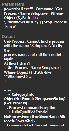

So the last thing we do before sleeping is execute the setup. Find that command in the script logs and see what its "return" was. If it was a "OK" then the agent executed the setup and received what it should of.
Else you may have some error there.
If it fails to install then copy that command that was run and go to agent, open up command window and rerun command and see what agent does.
The setup command is just a short launcher for another internal app that does the system prep and updates. Looking for the setup program after a minute or two will not show up. look for some update app to be running that is consuming alot of cpu time.
