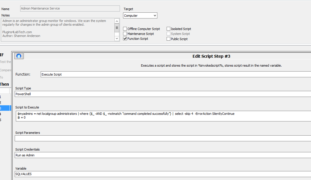

The script pushes down a Powershell file to run that pulls the administrators of the local group. If script can not write a file to the system then this will fail .

We use a basic script that calls a powershell script and based on the return we place that into SQL.
If you have issues running this then it sounds like the script engine for LabTech is not letting you execute the POSH function correctly. Might inquire to CW support on why POSH functions in script engine fail with that error? They may have a quick fix.

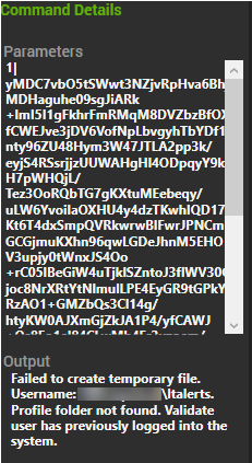

By any chance was a solution ever figured out for this issue? I'm on the latest version of the admon plugin / CW Automate and this is happening to me as well. I have a client with about 530 machines and about half of the machines are checking into admon.
I've attached the output from a computer the script failed to run on. We definitely have the domain admin account setup in labtech for the client. Any help would be greatly appreciated!
