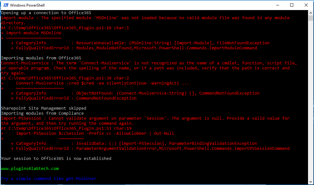

There may be times when a Tech's PS console fails to load correctly after installing and verifying modules were installed. The problem is that modules were only installed to the 32 bit side and not the 64 bit side and the Tech's system is a 64 bit system.
The Error!!!
