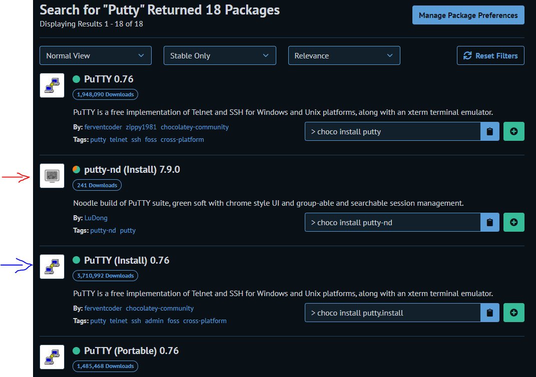

A good example of this is on Chocolatey.org site.
Searching for Putty on the Chocolatey.org site returns several Putty packages. Some at different versions then others and some that are not installable but portable. Also check the repo for mention of installer. This will add some insurance that its going to report to Windows that its installed.

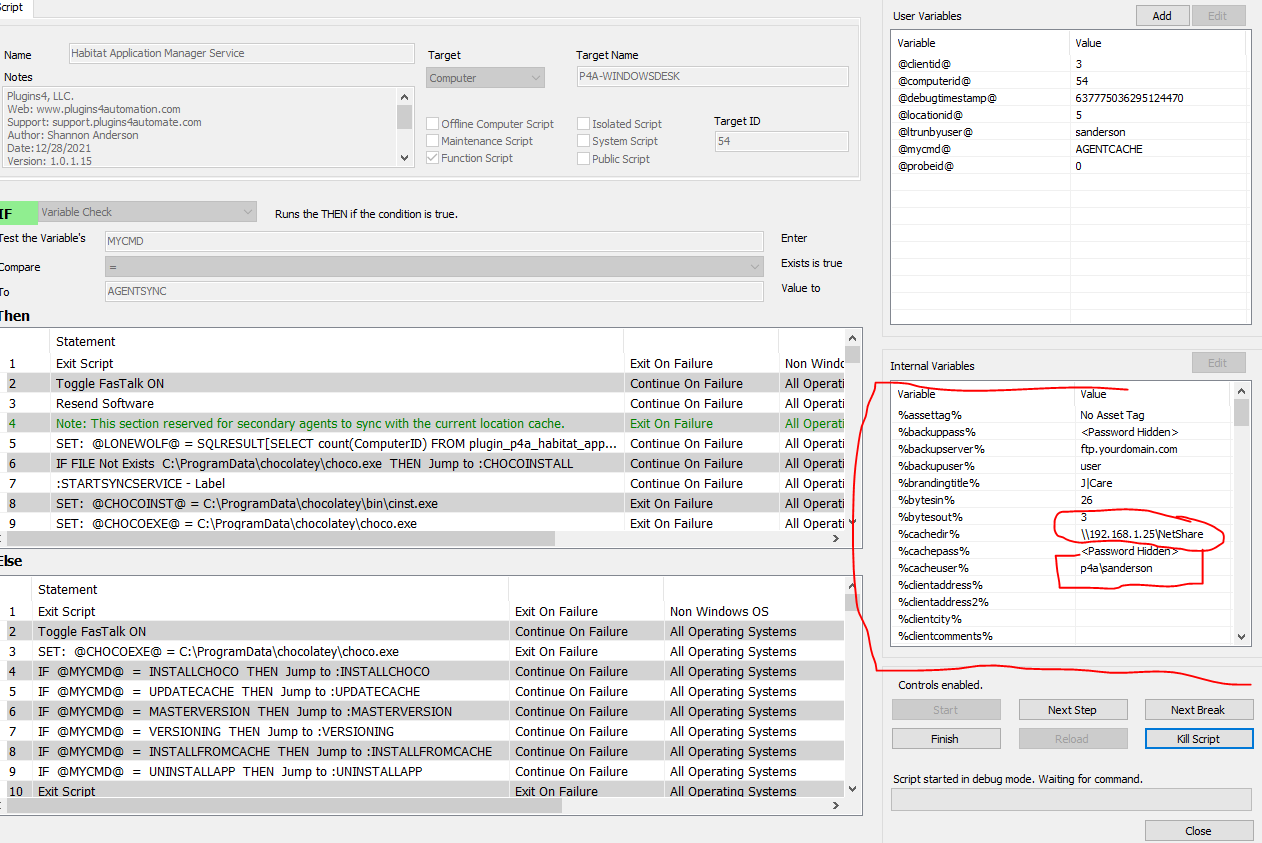

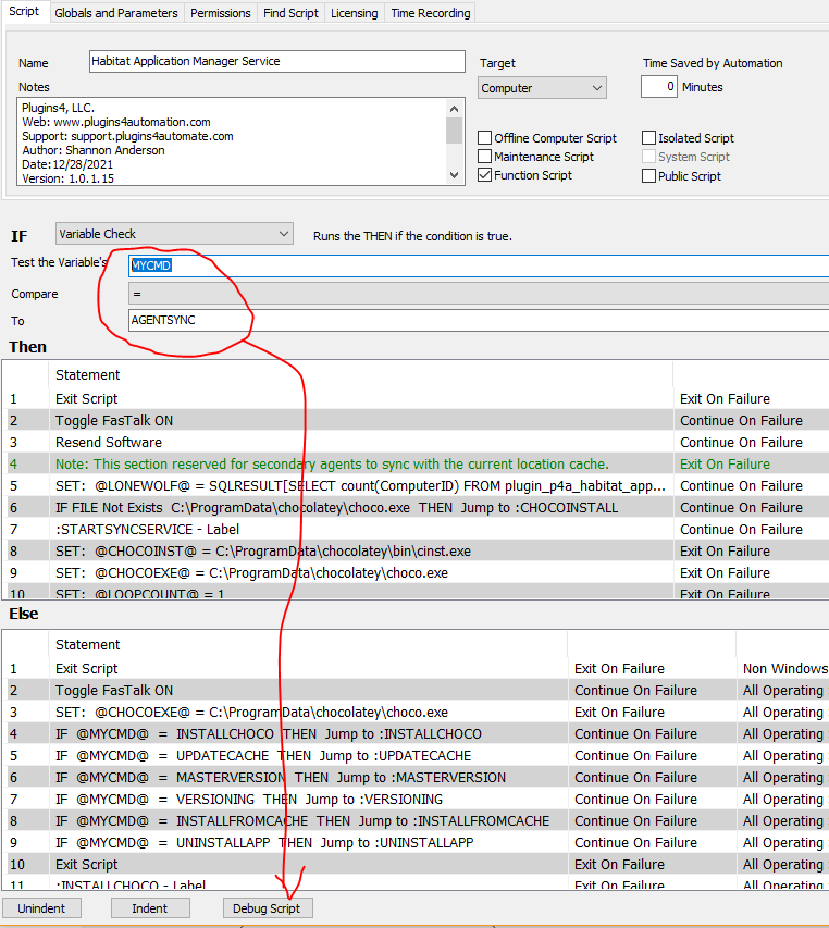

Posted: Tue Jan 11, 2022 6:17 pm
Sure can!
Open the script

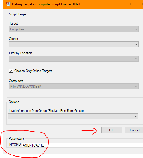

Use AGENTSYNC as the task, it will be the easiest to follow. Select DEBUG Script. Tes it says AGENT CACHE but that is not correct it will be AGENTSYNC.
Place AGENTSYNC (not AGENTCACHE) in the field below and select a online agent to run against.
Start the script running and monitor the side windows for the variables to show up. That will be what the script is using.
Posted: Tue Jan 11, 2022 9:13 pm
by lblokland
OK, did the debug part..It sails at step 106, please see attachment, the output form the step as it is logged is as follows:
False
System error 1326 has occurred.
The user name or password is incorrect.
Test-Path : Access is denied
At C:\WINDOWS\system32\config\systemprofile\AppData\Local\14912a04a40c48b9bf6a11b26035f1d2.ps1:2 char:6
+ if(!(Test-Path -path '\\SOL-S01\SiteCache\Habitat\packages\')){New-It ...
+ CategoryInfo : PermissionDenied: (\\SOL-S01\SiteCache\Habitat\packages\:String) [Test-Path], Unauthoriz
edAccessException
+ FullyQualifiedErrorId : ItemExistsUnauthorizedAccessError,Microsoft.PowerShell.Commands.TestPathCommand
New-Item : Access is denied
At C:\WINDOWS\system32\config\systemprofile\AppData\Local\14912a04a40c48b9bf6a11b26035f1d2.ps1:2 char:64
+ ... ackages\')){New-Item -ItemType directory -Path '\\SOL-S01\SiteCache\H ...
+ CategoryInfo : PermissionDenied: (\\SOL-S01\SiteCache\Habitat\packages\:String) [New-Item], Unauthorize
dAccessException
+ FullyQualifiedErrorId : ItemExistsUnauthorizedAccessError,Microsoft.PowerShell.Commands.NewItemCommand
I tried to change the password to something simple (it had a lot of symbols in it) but that didn't help, same error.
After a few attempts the account is locked out in AD, so I'm 100% positive the user part is good.
Looking in the CWA database in the locations table, I can see the password for the location account is in clear text, and it is correct, so I'm also sure that it is correct in the database.
After the password change tried to logon to the agent again, and read,write and delete in the sitecache share. No problems here...
Something is going wrong with the password in that test script / step...
Can you help me out to run those test-path commands in powershell? I cannot find the commands that the script is using..
Thanks.
