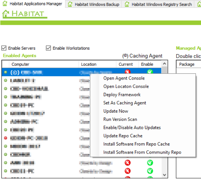

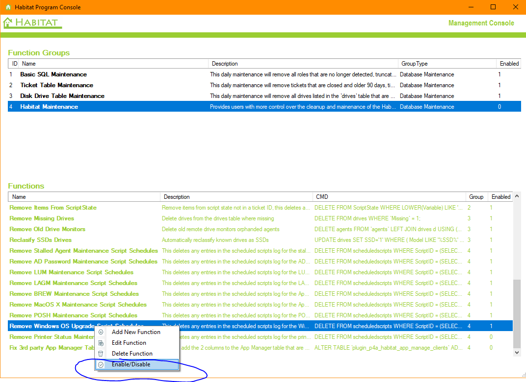

It should enable and disable individually as well as a group. Looks like the enable is working but disable may have syntax issue causing it not to save and thus you never see it flip to disabled.
I'll look in to that.
Yeap, found it.
Look like it works fine here
But only enables here and not disables when selected.
This is just a minor logic issue in the viewer, ill get corrected.

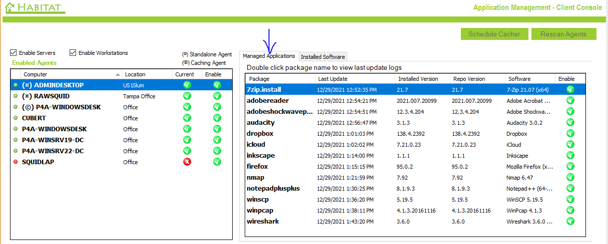

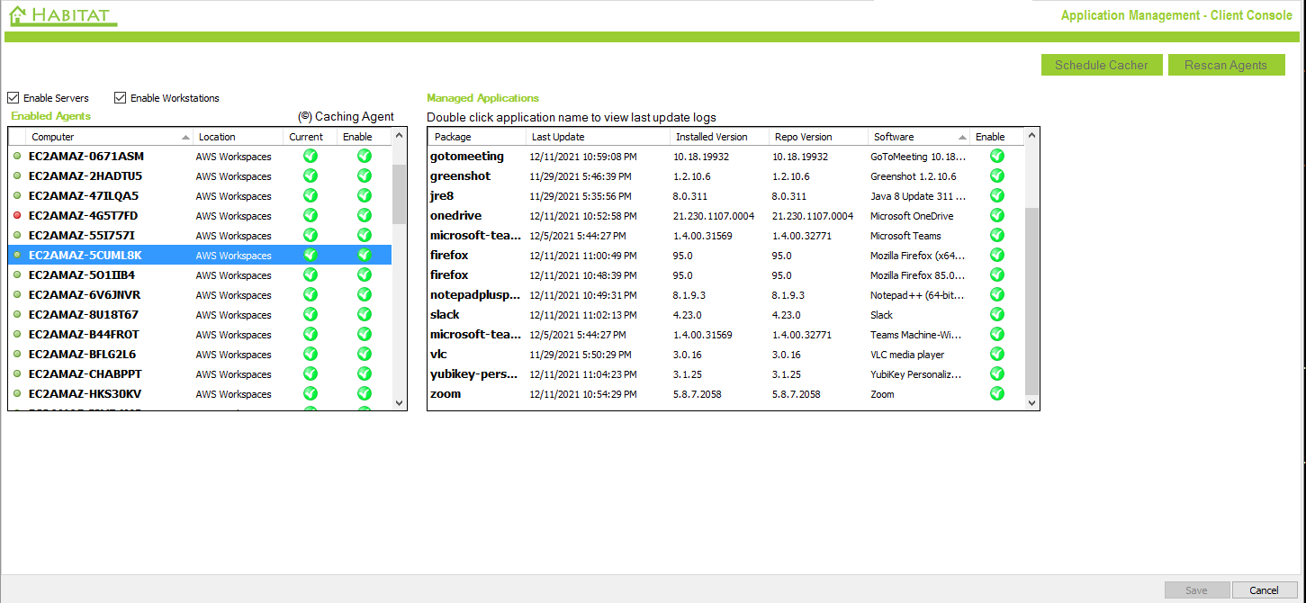

Is there any way to make the Managed Applications Window use a percentage of the remaining width or height?
It would be helpful to see more of the Software name, or even possibly more rows if that's an option as well.
Either way, thank you for adding the software column. That's a big help in certain situations.
Habitat managed applications window.PNG (75.4 KiB) Viewed 13350 times

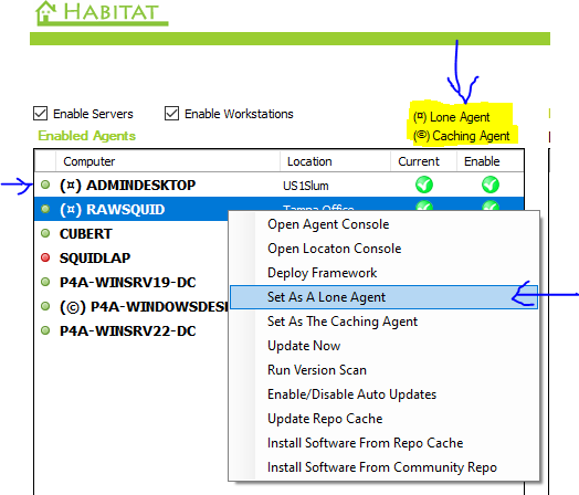

In build 1.0.1.15 I have added a new function called LoneWolf which identifies agents that are going to skip the caching process and instead attempt updates directly with Chocolatey. You will assign this status in the same way you assign a caching agent.

New Lone Agent function.
Set any agent as a lone agent will cause that agent to install direct from Chocolatey. Beware of possible limiting from Chocolatey if max connections are reached by location router addresses.

Next I agree on the standalone agent rename, done...

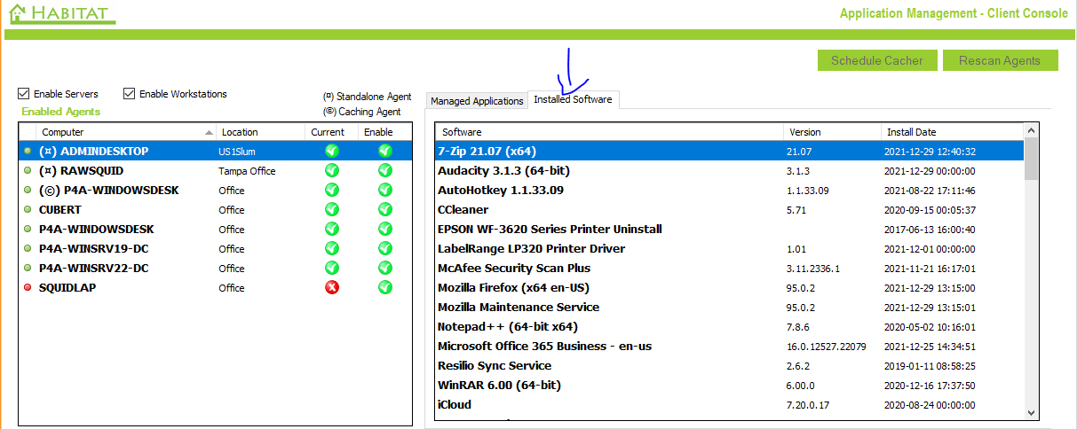

Lastly, I found that having quick access to the installed software list as reported to Automate in the plugin along with the Applications being managed makes it much easier to see if applications are matching up. So I have added a tab view for the split of managed applications to installed software for each agent.
The Managed Apps List
Installed Software list
And from the view here looks like the Standalone deployments and updates launched yesterday as expected, That's a go..

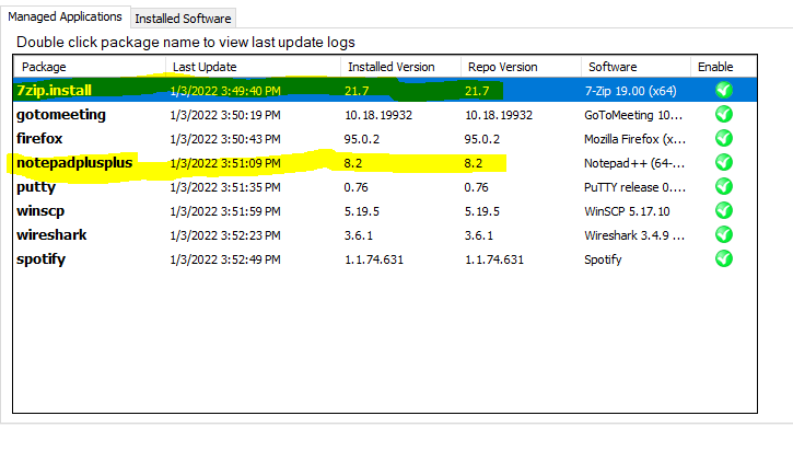

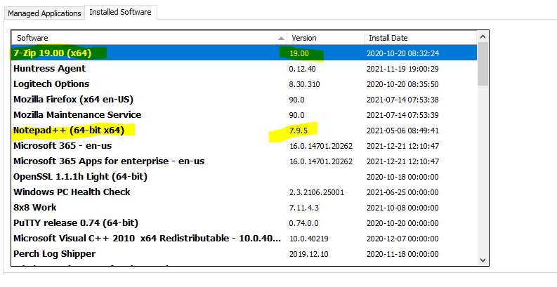

Hello, just getting setup using the 3rd Party Application Management and I am seeing an issue in my deployment where on all my agents (one client at this point) the Installed Version is the same as the Repo Version, even though when I check the new Installed Software tab (updated to 1.0.1.15) it shows an older version than the repo, as well as when I check the acutal application version on that machine. See the below screenshots.
