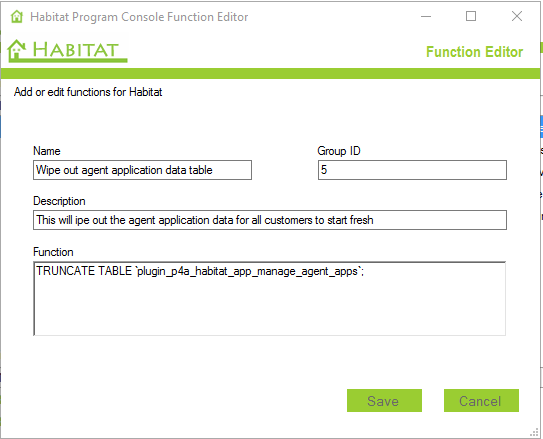

Your recommendation for running a truncate on the app table is a good idea as I was noticing legacy information that didn't get cleaned up automatically.

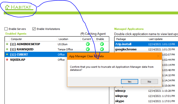

Habitat app table truncate.PNG (12.74 KiB) Viewed 15399 times
I added this to the Habitat Database Maintenance tool since I have a hosted server and running command directly is usually an issue. Maybe there could be a consideration to add some built-in maintenance functions in that console to automatically truncate certain areas after data becomes old when manually toggled. Might be worthwhile to make it easier to clean things out every 6 months to drop any stale data. However, the disable/enable button on individual functions does not work, so you have to enable and disable entire categories to disable a function.

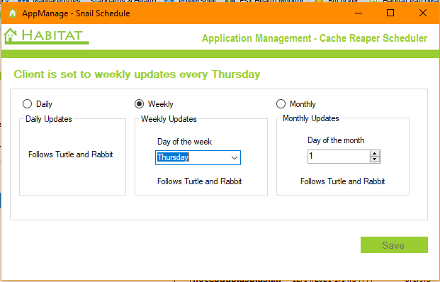

There is still something wrong with the schedule. The schedule doesn't appear to be activating when switching back and forth between daily and weekly mode, even when it says it has saved. When I look at the LT script logs, I can see that the Habitat App manager scripts don't actually kick off as corresponding to the schedule type. The problem can be in either direction. I think that is part of the problem I was previously reporting. Honestly, I think it would be better to have three radio boxes where you could select Daily, Weekly, or Monthly and then press save. Having a radio button for all three would be more intuitive and probably more reliable in the long run as there have been problems with the current method not working as expected. For example, I switched two customers to daily at the beginning of the week to test this, and the schedule clearly says daily, but the last script run was a week ago on the previous weekend scheduled day when the schedule was weekly mode on the weekend. But when switching back to daily, the scripts aren't activating on daily. Previously I was seeing this in reverse when the scripts would not kick off on the day of the week the weekly schedule was set to. I was also still having issues with turtle mode on either, but if I just stick to Rabbit mode, that would be fine as long as the glitch in the schedule is fixed, but if I switch back and forth a few times and restart the database, then things kick back into gear, or so it seems.

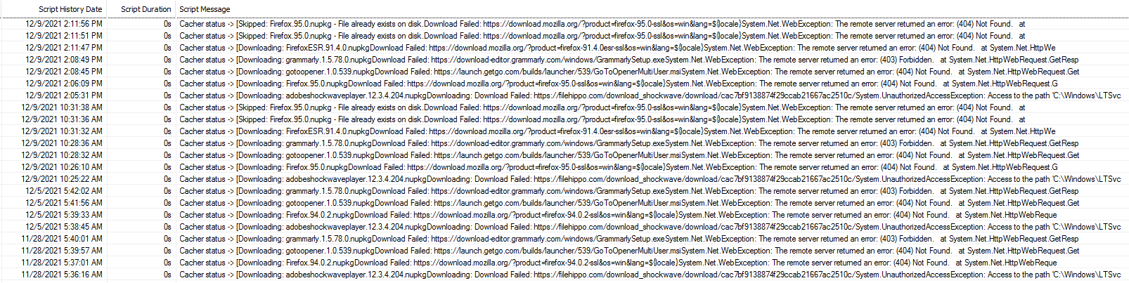

There are issues downloading some package files. Part of this may be just an issue with bad packages, but I wanted to run this by you just in case. This issue deals with specifying variables in the download source link that is not valid. For example, the issue with Firefox is that it includes the "locale" variable at the end of the download line, which is not valid.
Download Failed: https://download.mozilla.org/?product=f ... g=${locale}
If I remove the "&lang=${locale}" at the end of the line, it works. It seems like it might be a Firefox package or site issue, but if that is related to the parsing from Habitat in any way I wanted to bring it up.
Here is a list of various package download issues I am seeing, which may be issues with those packages or possibly with Habitat.
Habitat cache.PNG (114.15 KiB) Viewed 15276 times
Item 4.

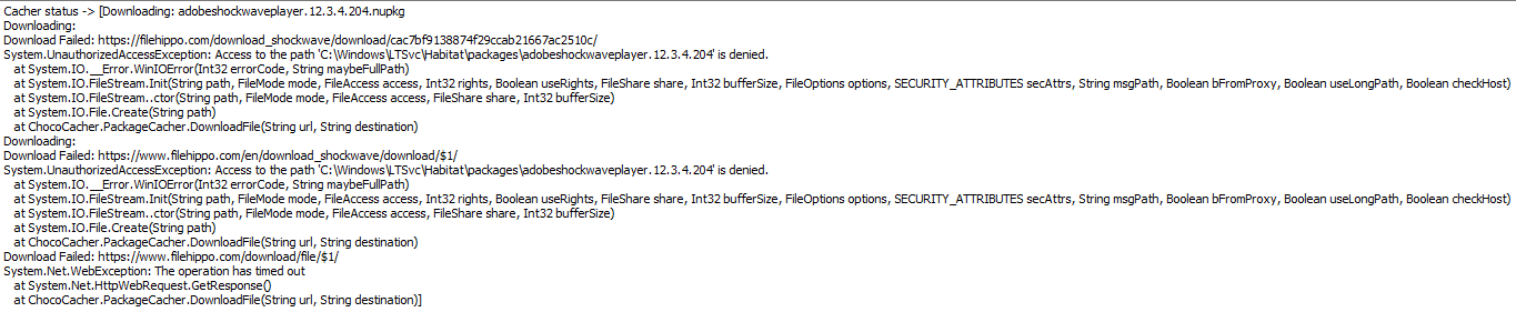

There are issues with the package download on the Caching Agent, even though the downloads almost always complete. This may be related to the issue of applications and versions not populating. Specifically, I am seeing "Access Denied to the path 'C:\Windows\LTSvc\Habitat\packages". This is shown on every application listed but only shows on the Caching Agent system.
I don't know why it would be downloading there because that is not the cache location, unless it is trying to copy from the "Script and template variables" Drive.
Here is an example.
Habitat cache access denied.PNG (38.08 KiB) Viewed 15276 times
To be more specific, on the caching Agent/Server every application triggers a "Checking repo cache for [application_name]"
On every package, it always triggers the following error every time it goes through a repo cycle.
"Cacher status -> [Directory 'C:\Windows\LTSvc\Habitat\packages' does not exist.]"
That is not the repo cache directory, so it doesn't make sense why it's checking the default LT Habitat location for a packages directory as that is not the configured Habitat packages directory. The configured packages directory as specified at the LT site level is where the packages directory exists.

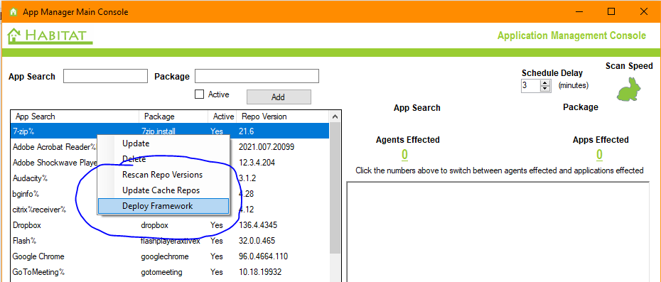

Would it be possible for a repository rescan button on the Application management main console instead of waiting overnight for that particular script of Habitat to kick off. I say this because if I'm troubleshooting something and I change the list of global applications, the repository field will say none until 5AM. This can be problematic if I'm troubleshooting something. I'd like to be able to press a button that allows the global application list to rescan the Chocolatey repository and record the version information. I'd also like to see a reset button that clears all the values to none so I can then press a rescan button to recheck all the versions, which can wipe out any legacy applications that no longer have valid repository information in Chocolatey. This would be helpful when troubleshooting applications and removing stale applications that are legacy or if there is any problem with the list. For example, this screenshot shows applications I was troubleshooting, but I have to wait overnight to see if the version populates, confirming it is working.
Habitat Search.PNG (47.18 KiB) Viewed 15258 times

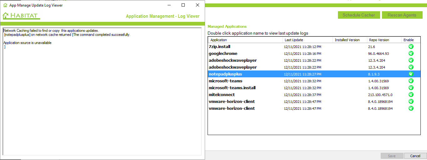

In some situations, the installed version column is still not showing up, and there is an error stating, "Application source is unavailable". These systems pass all the script checks, and some systems in the same site are showing up correctly. See the screenshot below to so you can see what I mean.
Habitat app error.PNG (43.43 KiB) Viewed 15227 times

#1 There are now three radio boxes where you could select Daily, Weekly, or Monthly when scheduling updates.

#3 New repository rescan versions, deploy framework and App update controls on the Application management main console. These functions control all clients currently enabled.
