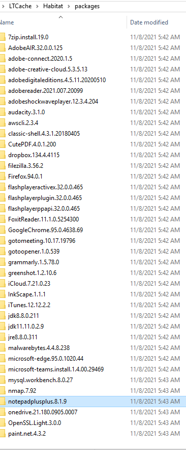

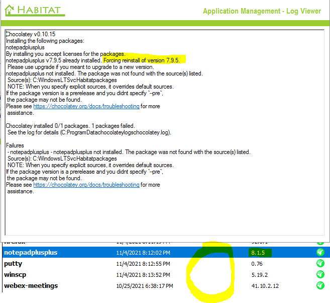

Also, some applications are not downloading the packages even though the package ID is current on the Chocolatey public site and it's updating the package folder with the new and correct version.
Here is a partial list of all the packages I am trying out, and you can see the time stamp shows that it's checking and updating the folder names. However, that also shows that the repo version listed in the Main console and on the customer console isn't being updated, because its making folders with the new version numbers, but not actually updating those versions in the consoles. Notepad plus is a good example, as it says 8.1.5 in the main console and this screenshot in the customer console. However, the folder in the packages directory and in the public repo show the actual current version 8.1.9.

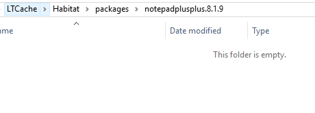

However in this example, with notepadplus, the folder is empty.

Well, I been working half the day on this issue, yea we had an issue in the script, several actually.
So you should be looking for a new script version in this build. I am testing now and should have a release tomorrow AM if all automation runs well tonight.
We found several issues.
#1 Master versioning was not happening correctly. We had a mis-labeled label causing a shift in function when running master Version function. This caused versions to be missing.
#2 We had several SQL errors to correct for updating data
#3 We added to command the version to install which resolved the reverting to installing the original package.
So 3 bug fixes that were causing issues you mentioned should be fixed in Build 1.0.1.12
I'll get it out tomorrow!
Also I would flush the plugin_p4a_habitat_app_manage_agent_apps table for good measure. Had some junk get in there due to SQL update error we fixed today. caused duplicate entries with data switched.
TRUNCATE TABLE plugin_p4a_habitat_app_manage_agent_apps
This will cause all agent app data to be gone. Allow for next AgentSync to happen and correct data will be present.
As for the empty folders in the repo cache.
That is to be expected and is perfectly ok. Many of the NuGet packages are fully embedded so there is no extra package dependencies or executables needed. The Public repo still passes us a folder it expects to be there empty or not.
The issue above was called by not passing the Version you want installed to the choc installer executable so it failed with the rollback message.
That should not happen now in build 1.0.1.12
