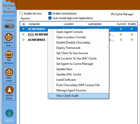

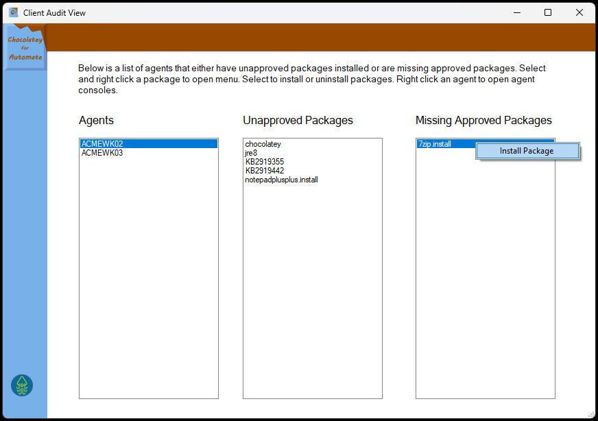

I just pushed out 3.6.0.8 that now includes a new Client Audit Tool,
This tool will display a list of agents that currently do not completely follow the clients approved package policy. This tool will allow you to install or uninstall any package listed in tool. You can also launch the agents console from the tool making it quick to jump over to agent command logs to see tool in action. All install and uninstall commands sent from tool are direct commands to agents and are not monitored for success or fail. The agent will be rescanned on next scanning interval and will adjust its packages installed list at that time. If you want to see the updates in the plugin immediately the you will need to force a agent scan and allow scan to complete.
To open Audit Tool:
Install Missing Software on agent (7zip)
Re: C4A 3.6 updates/changes
Let me know how it works for you.
