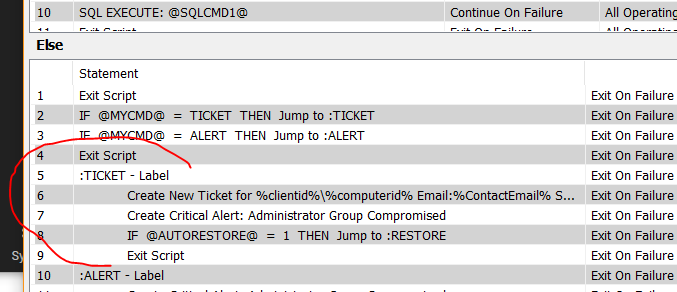

How can I manipulate this Monitor?
We have Automate linked to CW Manage, and we do not look at tickets in Automate at all. We have Ticket Categories set, which map to CW Manage and create tickets there.
How do I set the Ticket Category on these tickets so that they create tickets in CW Manage for us?
Re: Habitat Local Administrators group Monitor (LAGM)
Posted: Tue Jun 08, 2021 1:12 pm
The tickets are created inside the LAGM script inside the scripts\maintenance script folder in Automate. There is a sub function in the script that when called from script creates the ticket. You can edit this function changing the values where it creates and modifies the ticket.

Is there a way to rethink this and have tickets/alerts created from an actual monitor?
We use CW Manage PSA integration, and use CWM for our ticketing.
But not all CWA tickets go to CWM. We do it based on the Ticket Category. And we've found we were unable to set the Category on a script-created ticket (If you adjust the category after ticket creation, that does not affect the CW Manage plugin. So the ticket has to be created with the correct category). So these LAGM tickets live in Automate only where we won't see them.
Having this be on an internal monitor (with a SQL query against the LAGM Habitat table maybe?) would allow us to set this to an alert template and ticket category that will send it to our ticketing system.
(It would require a bit of retooling, as the autorestore is built into the ticketing/alerting. So you'd potentially lose the ticket when you have autorestore enabled. (Or just get the CWA ticket/alert)
