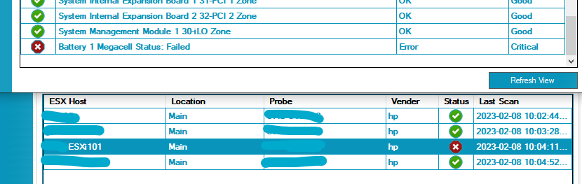

As for the batter showing a 5, that maybe a script issue not capturing state correctly for that item. I will need to go in to python script and see how they are extracting that information.

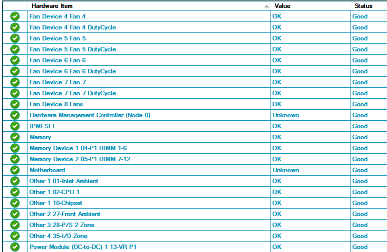

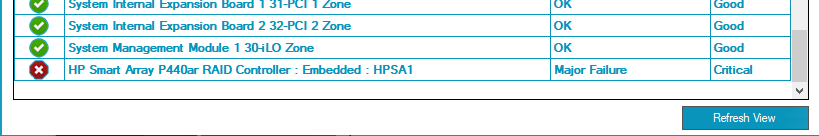

I checked the CIM data but there is no such element called "HP Smart Array P440ar RAID Controller : Embedded : HPSA1" in the CIM data window.
Screenshot 2023-02-03 121546.png (68.4 KiB) Viewed 181784 times
I sorted by Hardware item

As you see above we have a line for the failed array going into your database as a query.
,( %clientid% , %locationid% , %computerid% , '@sqlESXHost@' , 'HP Smart Array P440ar RAID Controller : Embedded : HPSA1', '20')
So for that not to be there in the table when you go to read it out is a scratch you head moment.
But,
I suspect that its the "Ignore" in our SQL statement that would allow record to be discarded if it did not meet table requirements.
INSERT IGNORE INTO `plugin_p4l_vmware_healthmon_cimdata` (`ClientID`,`LocationID`,`ProbeID`,`ESXHost`,`CIM_Item`,`CIM_Value`) VALUES @CIMSQLDATA@ ON DUPLICATE KEY UPDATE CIM_Value=VALUES(CIM_Value)
So lets try this, Place the following code block into your SQL Yog and execute the sql query, see if it yells at you for any reason. If not, go check you CIM data in the plugin now for this item to be available. otherwise I suspect you will receive an error for some reason,
INSERT INTO `plugin_p4l_vmware_healthmon_cimdata` (`ClientID`,`LocationID`,`ProbeID`,`ESXHost`,`CIM_Item`,`CIM_Value`) VALUES

I tried to run the SQL query and that worked without any errors.
The CIM data now shows the RAID controller failure.
Screenshot 2023-02-07 105749.png (17.65 KiB) Viewed 181740 times
The overal device status shows okay still but I guess that is due to the fact we manually inserted the data into the table.

I noticed this morning that now the same server is showing this:
Screenshot 2023-02-08 101426.png (40.94 KiB) Viewed 181727 times
Any idea why that is?
Re: How-To Manually Test Probes
That's a head scratcher..
Make sure the dates of the data are changing as probe updates... so we know its fresh data.. Monitor it a few days to see if stops updating.
