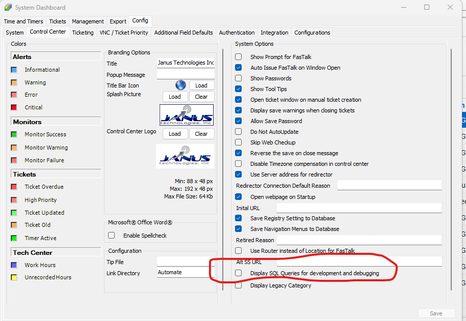

Can you fire up SQL Spy in Automate server and lets look at the queries that are being made and the responses when you open a client with an agent with software installed. You can enable SQL spy here in the Automate configuration dashboard.

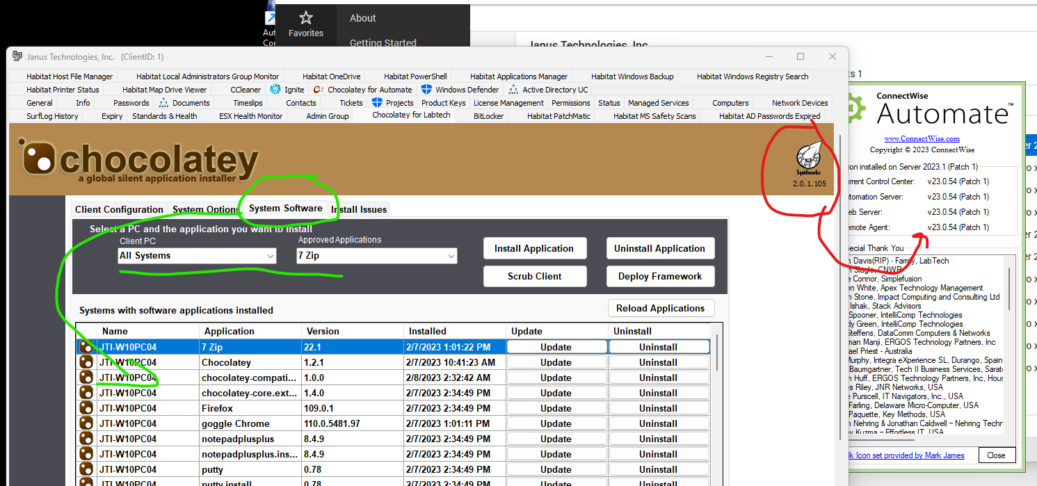

Here is our systems view of the same location. We can not recreate the current issue your referring to in our environment. We are on C4L build 2.0.1.105 and CWA build 23.0.54 which puts us fully up to date with both plugin and CWA.
