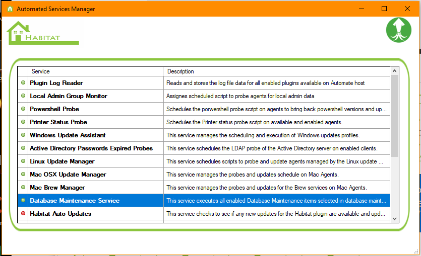

You will also need to make sure that the database maintenance service is enabled in the Automated services tool. Otherwise this whole service is disabled.

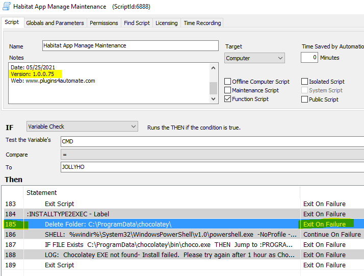

The Choco install on new systems is failing on line 185. Can you change that line to continue on failure because that folder may or may not exist at that point depending on where the previous failure may have occurred?

When you get a chance, please change line 185 to continue on failure so we can start getting habitat installed. We still need that line to clear out a failed install, but if the software isn't yet installed, it needs to continue on failure or it won't launch a new install.

Posted: Mon Jul 05, 2021 1:58 pm
We show that was changed in build 1.0.0.75 for that script, Is that the version your seeing currently.
I will go ahead a refresh the script as build 1.0.0.78 just to make sure its correctly being delivered.
Posted: Tue Jul 06, 2021 4:40 pm
by dbitters
I show the version of the script to be 1.0.0.75 but 185 still saying exit on failure.
Please see the screenshot below. Thanks for your time.
Habitat Script.PNG (30.38 KiB) Viewed 16481 times
Posted: Wed Jul 28, 2021 3:18 pm
by dbitters
Thanks for the previous adjustments.
I have a follow-up request on this.
In the maintenance script between lines 187 and 188, can you add a log output of the results?
I'm asking because if the install failed or if the install was blocked due to too many requests, it is very helpful to easily see the output of a failure with the other outputs instead of hunting for it.
Maybe something simple such as:
Log: Results: @ChocoResults@
Also,
I'm noticing that when the install fails from too many requests, that the loop triggers it to wait a minute and continue again. Unfortunately, if all the systems are firing off at the same time and if they are all waiting the exact same minute for the 2 retires, then they all just fail again because they are again all firing off at the same time. I'm wondering if there is a way to set a random number between 1 and 240 on how many minutes to wait before trying again. That should get it around the Chololatey's limiter, but I don't know if that is possible in labtech.
I'm not sure if you are up for this next idea, but one thing I like to do immediately after the Chololatey install is to show the version in the labtech log output before resuming in the script. This is so when dealing with the hassle of getting Chocolatey installed and constantly checking the logs, I know it is a valid version and I'm not wasting time troubleshooting if the version number can't return a valid value. Maybe you can add this immediately after line 186.
Shell: C:\ProgramData\chocolatey\choco.exe -v and save results to @ChocoVersion@
Log: Chocolatey Framework version @ChocoVersion@
Thanks for your time and consideration on this.

dbitters wrote: Wed Jul 28, 2021 3:18 pm Thanks for the previous adjustments.
Also,
Ok with release of 1.0.0.79 you will see each of your request additions. The Random loop sleep was actually fairly easy. just called a one liner POSH command to get a random number between 60 seconds and 30 minutes (1800 seconds) then set sleeper to that value. Lastly I added a version log message after line 15 which is where if install was successful and a choco.exe was found that it now logs its version.
The 1.0.0.79 release is going through some final testing for the new MS safety scanner tool we have added in this build. Should be release before this weekend.
