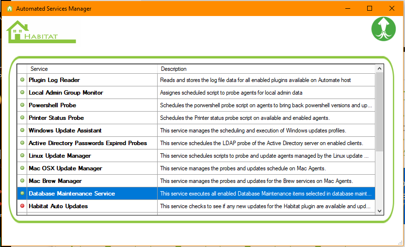

You will also need to make sure that the database maintenance service is enabled in the Automated services tool. Otherwise this whole service is disabled.

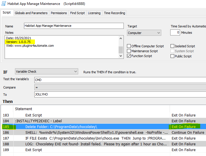

The Choco install on new systems is failing on line 185. Can you change that line to continue on failure because that folder may or may not exist at that point depending on where the previous failure may have occurred?
Thanks.
Yeap I can fix that. I'll look to add the scheduled time to the log entry during automation for updates so we can see exactly when it thinks it scheduling a script.

When you get a chance, please change line 185 to continue on failure so we can start getting habitat installed. We still need that line to clear out a failed install, but if the software isn't yet installed, it needs to continue on failure or it won't launch a new install.
We are looking forward to deploying this to all of our production systems.
Much appreciated.
We show that was changed in build 1.0.0.75 for that script, Is that the version your seeing currently.
I will go ahead a refresh the script as build 1.0.0.78 just to make sure its correctly being delivered.

I show the version of the script to be 1.0.0.75 but 185 still saying exit on failure.
Please see the screenshot below. Thanks for your time.
Habitat Script.PNG (30.38 KiB) Viewed 16472 times
