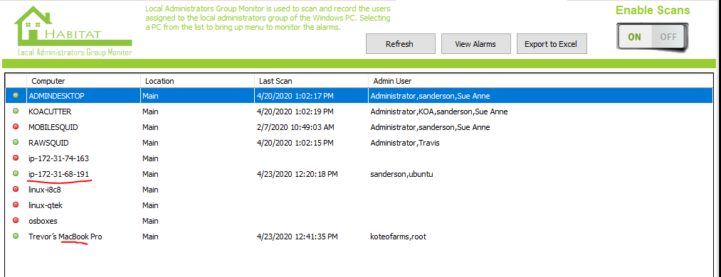

That's a pretty good start to it but it took just a wee bit more coding to get the data out and in to Automate.
But there she blows!!!
Now have Ubuntu, Redhat, CentOS, SUSE and Fedora admins now able to be seen. Should be available in build 1.0.0.38 when released.
