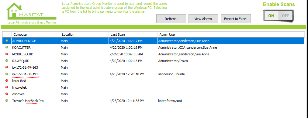

That's a pretty good start to it but it took just a wee bit more coding to get the data out and in to Automate.
But there she blows!!!
Now have Ubuntu, Redhat, CentOS, SUSE and Fedora admins now able to be seen. Should be available in build 1.0.0.38 when released.

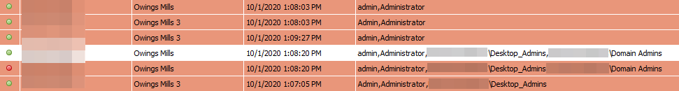

Hi Guys,
I have the LAGM plug installed. It is scanning my DC and populating some results in the in the domaini admins group, but it is not displaying the full list of accounts in that security group.
I am having the same result on a workstation local admin group. It does not list all of the accounts in the local admin group.
Any suggestions on how to get it to work? I have rescanned the computers and checked Monitor additions to admin groups

I enabled ticket creation for changes and am generating a lot of tickets for AD security groups, like Domain Admins, being added and removed depending on whether the user is working on their laptop in the office or remotely. I read through the forum but didn't see a fix for this scenario. Is there a way to keep these systems from generating tickets if they're not connected to the network?

I had to turn off the monitoring of additions and removals after 90+ alerts were generated for the two companies I was testing over the past 12 days. Way too much noise. Any thoughts on a resolution for laptops that come in and out of the office?
