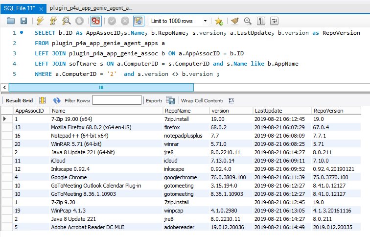

If you modify the SQL query and run it in SQL yog you can see that if software shows installed that it will return data. Lets remove a piece of the first query. The time clause... Lets just see if we have software installed updated anytime...
Here is that SQL request: (make sure to replace = '%computerid%' with '123' or whatever agent ID your testing against.)
SELECT b.ID As AppAssocID,s.Name, b.RepoName, s.version, a.LastUpdate, b.version as RepoVersion
FROM plugin_p4a_app_genie_agent_apps a
LEFT JOIN plugin_p4a_app_genie_assoc b ON a.AppAssocID = b.ID
LEFT JOIN software s ON a.ComputerID = s.ComputerID and s.Name like b.AppName
WHERE a.ComputerID = '%computerid%'
and s.version <> b.version;
The return data should look like this. This is my agentID #2 shown in image below. When I remove the data part of the where clause I get all the apps installed on the agent and their versions tested.

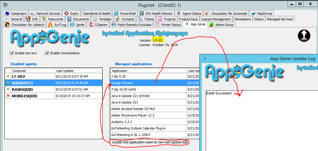

A new update to App Genie has been posted.
https://delivery.shopifyapps.com/-/c4f6 ... 042c8488a6
Plugin should auto update during the wee hours of the AM.
You should verify that the App Genie script is now version 1.0.22 by opening script and looking at script notes.
You should also now have a new database table (plugin_p4a_app_genie_update_logs) that will house the new logs as they are posted. Allow the system 48 hours to cycle through available updates before logs show up.
You can view the new logs for any software update by double clicking the software in the agent view.
You should now not only see when the last update ran but what was the output of the update command from Chocolatey framework. This should help troubleshoot if and why an update may have not worked for an agent or application.
