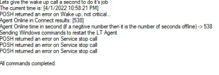

Re: Error running Stalled Agents
Posted: Sat Apr 02, 2022 4:00 am
by jtzabecki
Screenshot 2022-04-01 10.59.15 PM.png (64.15 KiB) Viewed 45103 times
Also seeing this whenever I try to use screenconnect to send the command. I am sure that it can communicate, just don't know what the posh error is.
