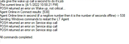

Screenshot 2022-04-01 10.59.15 PM.png (64.15 KiB) Viewed 45102 times
Also seeing this whenever I try to use screenconnect to send the command. I am sure that it can communicate, just don't know what the posh error is.
