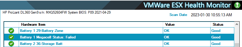

I've updated the plug-in and restarted the database agent but still no error reported after that I ran the SQL query but the status is still showing the same.
Is there anything else I need to do to make it work?
I did notice in the updated SQL quesry that errors 25 and 30 are not listed.
Is that because error code 20 or higher you consider critical?
Battery status is still showing OK

Re: How-To Manually Test Probes
I am see in a few oddities but I would like to see more data first before making any assumptions.
so first, I noticed that the raw CIM text sent to me didn't have a "vender type" sent with command so can I get a you to rerun the test command with the vender flag added.
C:\Python3\Python.exe -W ignore C:\Python3\check_esxi_hardware.py -v -H -esxi101 -U root -P blank -V hp
Next we need to see if this is the command being send via the script during a normal scan.
So in the script logs / command logs of the agent probe, look into the command logs for an "executing" function that would be calling "C:\Python3\Python.exe -W ignore C:\Python3\check_esxi_hardware.py -v -H -esxi101 -U root -P blank" and getting a return from probe.
We want to look at that command being sent to see if it has the "-V hp" flag anywhere in the command.
The issue I am seeing is that the raw data is:
20230201 11:42:59 Element Name = Battery 1 Megacell Status: Failed
20230201 11:42:59 Element Op Status = 2
Element Op Status = number represents the current status which in your case is "2", so all the HP add ins we did to types table has no bearing on this as 10,15,20,30 as status codes do not match status code 2. 2 is universal for "OK" or "Good". So either the python script is not getting correct vender sent to it so it mis reads CIM data or it is misreading this CIM data.

I ran the command as you specified and I got a different output this time.
I noticed this now:
20230202 09:44:26 Element Name = HP Smart Array P440ar RAID Controller : Embedded : HPSA1
20230202 09:44:26 Element HealthState = 20
20230202 09:44:26 Element Name = Battery on HPSA1
20230202 09:44:26 Element HealthState = 0
Which matches what I see in VMware but I also see this:
20230202 09:44:25 Element Name = Battery 1 Megacell Status: Failed
20230202 09:44:25 Element HealthState = 5
Which indicates no issue.
Is the script also adding the "-V hp" to script command.
If so then your CIM Data should be showing a raid issue as health state 20 is a critical issue.
