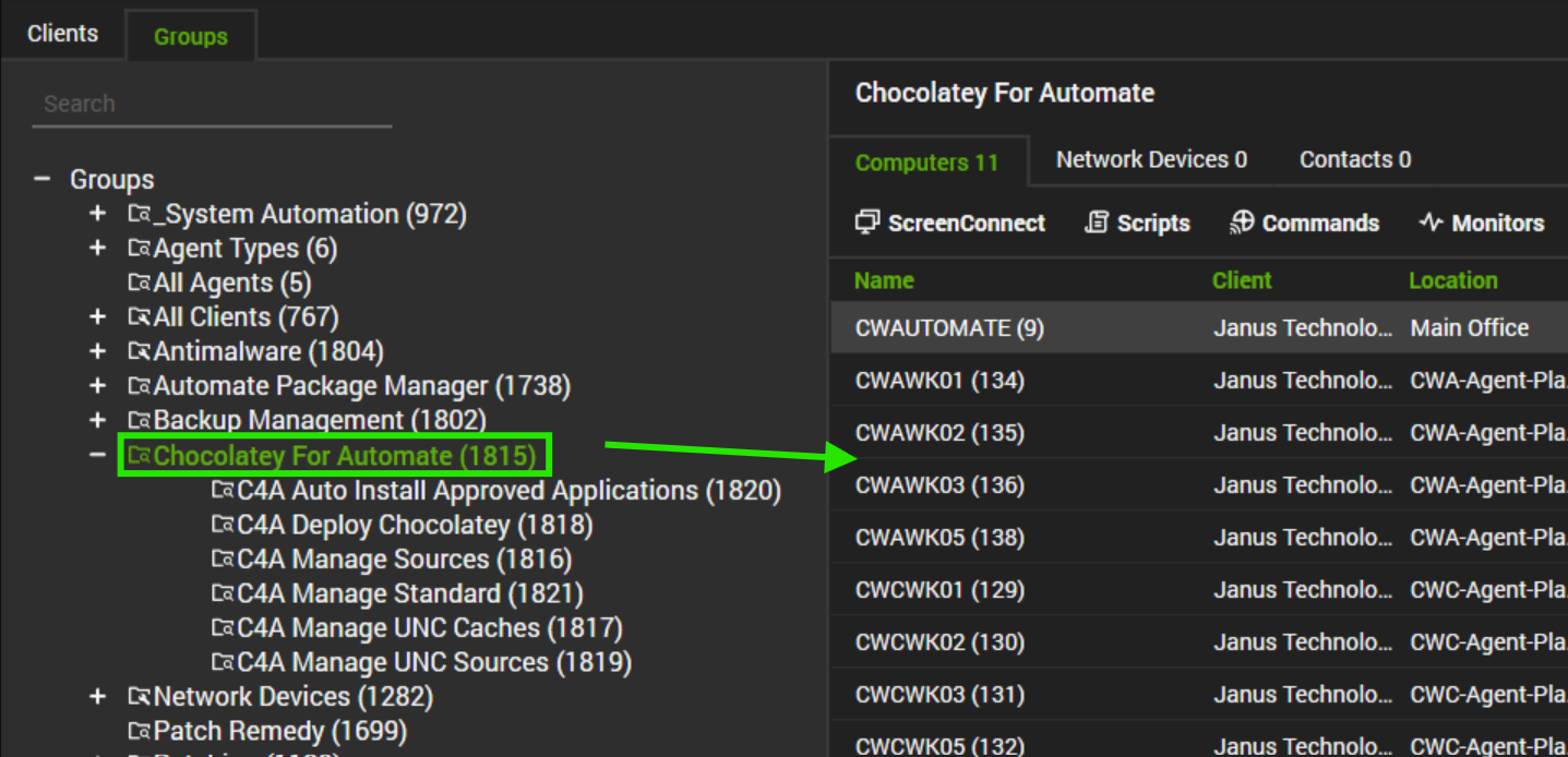

Ah, that's not right... Let me go check, it should be getting the same Group ID as the rest of the sub groups.
Won't hurt anything and will work as normal just not tucked away inside master group.

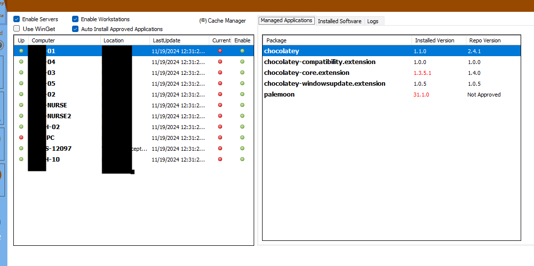

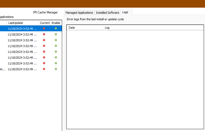

I got frustrated with trying to make this work over a year ago and although have not used it, have kept the subscription running, intending to get back to it once some of the bugs got straightened out.... hopefully some have.
Looking at it today, I noticed the same issue... the EDFs were selected, but they were not populating into the groups (all search settings and scripts were correct) - so I went into each client, DE-selected Enable Servers, Enable Workstations, and Auto Install Approved Applications, then RE-selected them, and the machines are starting to populate into the groups.... so hopefully THAT part is working.

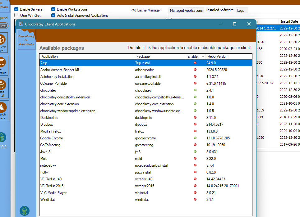

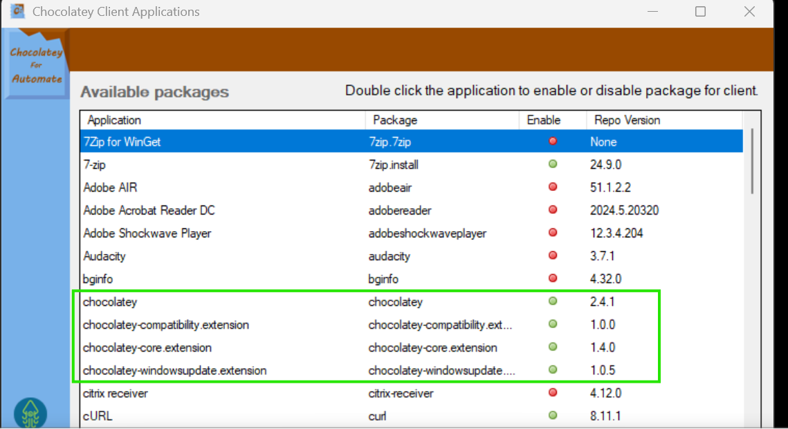

In attempting to set the "Approved Applications", I have gone into the main plugin interface and selected the apps I want to be enabled for all clients across the board (including the compatibility extension, windowsupdate extension, and core extension.... as well as 7-zip) - I went into each of those and executed Install Application Globally, opened each of them again and executed "Enable Application". I have waited a while, but when I go back into the client screen, there are still NO packages in "Managed Applications".
What do I need to do to make apps "Managed Applications" GLOBALLY without having to do it in each client?
And is it possible for you guys to make more searches for us to verify that everything is working properly (or help identify where it is breaking)? We can do it manually with some searches and scripts, but some should be provided.... such as a search group for "Failed Deployment", "Failed installation of Managed Applications", "No Managed Applications for these clients", and probably some others.

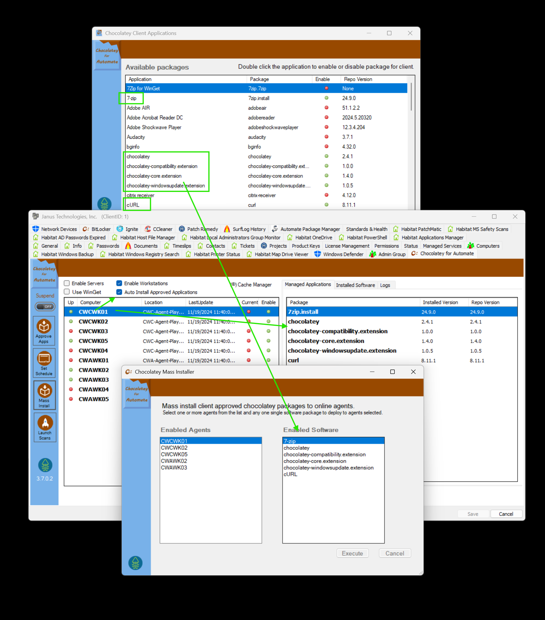

First things we want to check, are you on the latest build 3.7.2? Lots has changed over the last year so making sure we are up to date will help us resolve your issues.
The design of Chocolatey for Automate is not to manage clients as a whole. Things may take place that could cause issues you were not expecting and then it would be a global mess with a push of a button. But we do offer a function to push an application out globally or to remove an application globally. Just click an application from the global apps list to launch a application management tool.

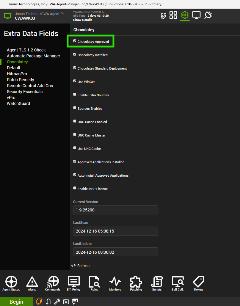

Everything we need to know about an agent can be summed up in the Chocolatey EDFs for the agent. Open the agent console and visit the EDF setting for the agent.
• Most Important – Is Chocolatey Approved? If not, what you are seeing in client console is accurate.
• Next, is Chocolatey Installed EDF checked?
• Do you have a Last Scan Date?
These two EDFs are key to the agent processing and displaying the current status of agent at the client console level. The last scan date lets you know when the last scan on agent happened.
How the system works. When you enable an agent for Chocolatey, the Chocolatey Approved EDF is checked. This causes the Chocolatey For Automate group to add the agent to their list.
Any agent in this group will be scheduled to be scanned by the P4A Scan Chocolatey Packages script daily. But before this can happen, another search takes place and sees that the agent is enabled but Chocolatey Installed EDF is not checked. This causes agent to join the C4A Deploy Chocolatey group. The agent remains in this group until Chocolatey is installed. When Chocolatey install script completes, it will change the EDF “Chocolatey Installed” to checked. This in turn cause the agent to disqualify for the C4A Install Chocolatey group and it will exit the Chocolatey Install group. Once this happens, the agent should be scheduled a normal scan during the next scan cycle. Once this scan completes, You should have agent package data and logs which were returned by the agent during the scanning script. You can check the agent script logs for script execution and returned data to validate agent is responding correctly.
The same process works for sources and caches, there is a EDF to enable the function, and a EDF to confirm the function was completed.
EDF:
Enable Extra Sources and Sources Enabled
Use UNC Cache and UNC Cache Enabled
Auto Install Approved Applications and Approved Applications Installed
Each of these EDFs have the other EDF as a validation that the function has been performed on the agent. If you wanted to let’s say, redeploy sources to an agent because of a change. Make the source change in the plugin, then uncheck the Sources Enabled leaving the Enable Extra Sources checked. This will cause the agent to rejoin the C4A Manage Sources group, That group will auto assign the C4A Chocolatey Sources script to agent, Agent will execute script and upon completion will have reset its sources to the current values assigned to it and will have rechecked the Sources Enabled EDF. This will then cause agent to disjoin from the C4A Manage Sources group.
Same goes for all three EDF sets. To stop Chocolatey on agent just uncheck the Chocolatey Approved checkbox and the agent will no longer scan or attempt any Chocolatey tasks.
I hope this helps you identify where along the path you agents reside and what to look for. You can adjust the script timing in the groups to speed up or slow down the processes. You can also add multiple schedules of the scan script in primary group, running scans 2 or 3 times a day. This will speed up flow of data. A typical agent may need up to 48 hours to start reporting data. This is because it maybe working its way through several temp groups as it gets configured to manage Chocolatey. The scanning of data is last on the list of configuration setups and must wait on other tasks to complete first. Adjust the group scripts schedules can improve this time frame some allowing to tune the performance of the plugin.
If you are still having issues, send me a screenshot of an agents EDFs and any script logs and I’ll have a look for you.

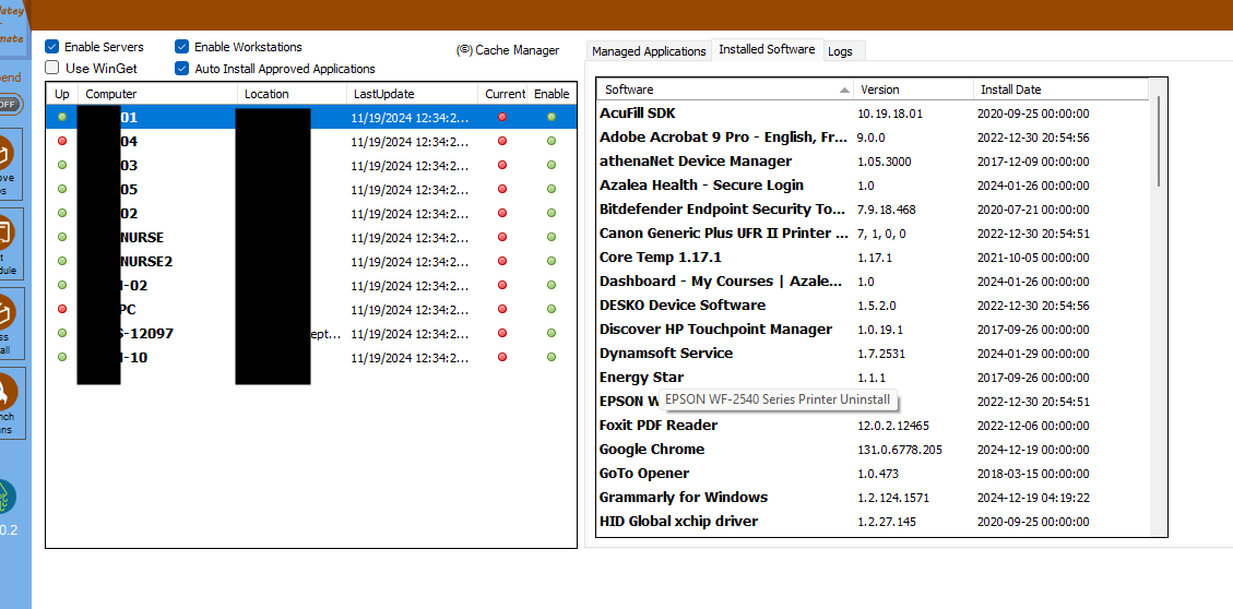

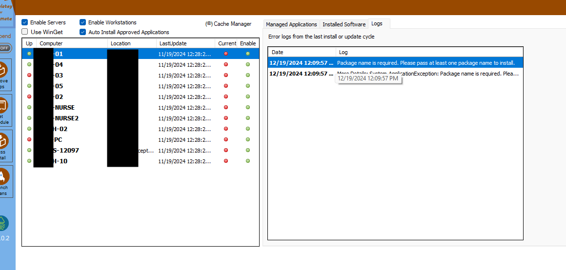

For the ones that I unchecked and re-checked Enable and Auto Install on yesterday, I am looking at a new client...
Yes, the version is current, but the latest one appears to be 3.7.0.2, not 3.7.2.
They are in the main group.

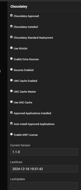

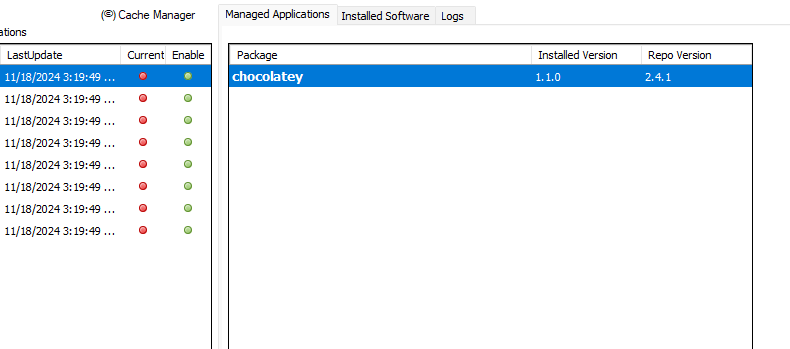

All of the agents in this client group now have Chocolatey as the only managed application....

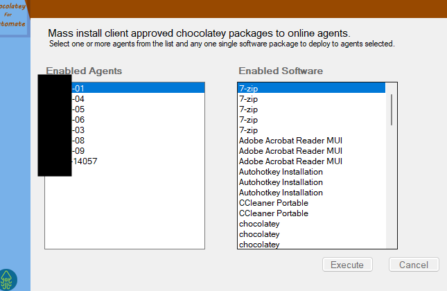

**** when I executed "Install Application Globally" for 7zip - is the application supposed to show as an "Approved Application" inside each client? Because it is not.... so I am manually approving it inside this client to see if it works now.
Here are the EDF settings for a machine in this client...
So it is approved and the last scan date is 12/18.
Not sure why the version is 1.1.0... maybe it was already installed? Shouldn't C4A have updated it? In the following screenshot, it shows that the "Last Update" was a month ago... not sure why - as C4A wasn't even enabled for this client until yesterday.

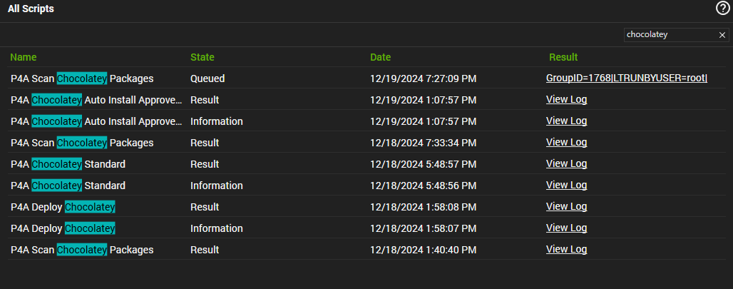

Several scripts have run since yesterday, but I am not sure which are relevant...
Like I said, I just enabled this client for C4A yesterday, so there have only been 9 scripts run on this machine I am taking as an example:
Here are the script logs (separated by a blank line - newest on top):

However, I did notice this... when I click "Mass Install", why does it show MULTIPLE instances of "Enabled Software" in the list?
mass install.png (26.32 KiB) Viewed 22881 times
Maybe this points to identify one of the issues??
I will also note that on the same client I am testing on (in the other post, etc.)... even though those 9 scripts have run, there are ZERO Logs in the client Chocolatey console...

Your first question:
When I executed "Install Application Globally" for 7zip, is the application supposed to show as an "Approved Application" inside each client? Because it is not. So I am manually approving it inside this client to see if it works now.
The short answer is no, it does not. However, I can see where that maybe should happen. We tend to err on the side of caution and try not to do too many things globally. The impact to an MSP could be significant if they are hosting 5K worth of agents and click the wrong button. This is why we typically do not make things automatically a global setting.
But in this case, by deploying an application globally, you are approving it for everyone that is currently enabled. I will discuss this with the team and see if we get consensus to make this adjustment.
That is exactly it. Chocolatey was already installed. During the Chocolatey Deployment function, the agent is first tested to see if Chocolatey already exists. If so, it captures the version and exits. The deployment process does not attempt updates.
The last update is auto set to 31 days old by default. As a new client, all agents start out showing as out of date. Once they start to scan and update, this data will become less than 30 days and the status will be green. The "Current" icon represents actions taken on the agent recently. Offline or failing agents will not show green icons.
That sounds about right. You will have scans by default daily. You will run chocolatey deploy atleast once on each agent. Twice means that the group rescheduled script a second time before agent actually ran script and completed. If this happens a lot then you can adjust the groups script execution from every half hour to every hour and that should resolve things. "The agent does not get demoted from group fast enougn to miss a second scheduling." Allowing more time between schedulings will give agent extra time to leave group after first Deploy Chocolatey script execution.
Next Question:
The Chocolatey Agent logs are currently pulled during daily scans and are a parsed subset of the ""C:\ProgramData\chocolatey\logs\chocolatey.log""
The chocolatey.log file is filled with MB's of data for each agent and can span weeks if not months. We do not want all that junk being saved into SQL inside Automate. To prevent this, we parse this log file by date and by CODE. We only save data that matches the date = today and CODE = \[ERROR\]. THis will only happen when issues arrise during installs, updates or sourcing issues.
Sample of the log:
2024-11-07 21:28:19,677 38032 [INFO ] - KB2919355|1.0.20160915
2024-11-07 21:28:19,680 38032 [DEBUG] - Sending message 'PostRunMessage' out if there are subscribers...
2024-11-07 21:28:19,682 38032 [ERROR] - Exiting with 0
I agree that we should also be using this area to post logs generated by our plugin. It makes since to include these here for reference. I will add this to our roster.
That is odd? I am not able to reproduce that error so it must be something inside you deployment. I would need to see the Approved software list for your client.
This is what it should look like.
Screenshot 2024-12-20 114353.png (684.85 KiB) Viewed 22848 times

On a side note!
It is good measure to include in your approved apps list Chocolatey and each of its dependencies. It greases the Chocolatey gears, making installs and updates more reliable.
Screenshot 2024-12-20 115727.png (187.71 KiB) Viewed 22844 times

L28 F109 Delimiter (P2): Variable (P3): @VERSIONS@ T: 46.390039
L29 F70 Value (P1): '('7zip.install','24.9.0'),('ad...' Comparer (P2): 9 To (P3): ) Jump (P4): 1 T: 120.6561198
L30 F67 Sql (P1): 'CREATE TEMPORARY TABLE temp_versions (repoName VARCHAR(255), Version VARCHAR(255));
INSERT...' T: 120.6561198
The Script(6264) failed in the Then section at step 30. The reason: SQL Execute failed processing query
Script: S6264 - Starting at Server Time: Friday, December 20, 2024 1:47:31 AM
IF F1 T: 0.6977011
L2 F20 SetType(P1):11 Parameter(P2):'Select count(*) from plugin_p4...' VariableName(P3):SUSPENDED T: 0.6977011
L3 F70 Value (P1): SUSPENDED Comparer (P2): 2 To (P3): 1 Jump (P4): 0 T: 0.6977011
L4 F31 Control (P1): 1 T: 0.6977011
L5 F20 SetType(P1):11 Parameter(P2):'SELECT count(*) FROM extrafiel...' VariableName(P3):USEWINGET T: 28.8338018
L6 F70 Value (P1): USEWINGET Comparer (P2): 2 To (P3): 1 Jump (P4): :WINGETSCAN T: 28.8338018
L7 F139 Note (P1): :STARTSCAN T: 28.8338018
L8 F154 Folder (P1): %LTSVCDir%\C4A T: 28.8338018
L9 F90 File (P1): %LTSVCDir%\C4A\scanpackages.ps1 T: 32.8603328
L10 F109 Delimiter (P2): Variable (P3): @PACKAGES@ T: 34.8859989
L11 F70 Value (P1): '('285','16','chocolatey','1.1....' Comparer (P2): 9 To (P3): ) Jump (P4): 1 T: 41.8783566
L12 F67 Sql (P1): 'DELETE FROM `plugin_p4a_chocolatey_installed_packages`
WHERE `ComputerID` = '285'; INSERT...' T: 41.8783566
L13 F235 T: 41.8783566
L14 F171 ValueOne (P1): 6 Operator (P2): 1.1.0
ValueTwo (P3): Variable (P4): T: 43.8827268
L15 F67 Sql (P1): 'REPLACE INTO extrafielddata Values('285',(SELECT ID FROM extrafield WHERE Name = 'Current ...' T: 43.8827268
L16 F235 T: 43.8827268
L17 F70 Value (P1): ChocoLogs Comparer (P2): 9 To (P3): ) Jump (P4): 1 T: 47.9043725
L19 F20 SetType(P1):11 Parameter(P2):'SELECT count(*) FROM extrafiel...' VariableName(P3):UNCENABLED T: 47.9043725
L20 F70 Value (P1): UNCENABLED Comparer (P2): 2 To (P3): 0 Jump (P4): :TESTSOURCES T: 47.9043725
L21 F139 Note (P1): :TESTSOURCES T: 47.9043725
L22 F20 SetType(P1):11 Parameter(P2):'SELECT count(*) FROM extrafiel...' VariableName(P3):SOURCEENABLED T: 47.9043725
L23 F70 Value (P1): SOURCEENABLED Comparer (P2): 2 To (P3): 1 Jump (P4): :RUNVERSIONSCAN T: 47.9043725
L24 F235 T: 47.9043725
L25 F139 Note (P1): :RUNVERSIONSCAN T: 55.9318391
L26 F20 SetType(P1):11 Parameter(P2):'SELECT distinct group_concat(R...' VariableName(P3):SOURCEPACKAGES T: 55.9329511
L27 F90 File (P1): %LTSVCDir%\C4A\packageversions.ps1 T: 55.9329511
L28 F109 Delimiter (P2): Variable (P3): @VERSIONS@ T: 57.9417559
L29 F70 Value (P1): '('7zip.install','24.9.0'),('ad...' Comparer (P2): 9 To (P3): ) Jump (P4): 1 T: 136.2105445
INSERT...' T: 136.2105445
4. A couple of logs are showing up now...
Logs
Logs
Managed apps
Managed apps
Installed software
Installed software
5. Approved Apps...
Approved apps
Approved apps
Yes, I have thought there was something wrong in my deployment for a LONG time, since I have never been able to make ANY aspect of this plugin work... for what, 2yrs now? Granted, I have only dug in a time or two - but got frustrated every time I (or a tech that I have delegated it to) has tried...
I think you need to provide some sort of script that generates you a support file that I can send to you... it should have info with EVERY RELEVANT ASPECT of my system about the tables, scripts, versions, etc. in order for you to determine what the issue is without our having to go back and forth on this forum with screenshots and manually typed theories about what MIGHT be happening.... either that, or someone needs to remote to my machine and check everything out to see what is broken.
