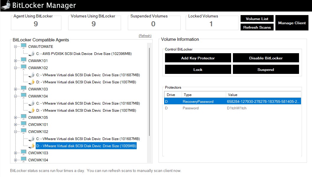

It was easier to create a quick video then to write out the process and add all the images is the correct order.
The video is 5 minutes long where I (today) take a computer not enabled for BitLocker and from start to finish, enable, encrypt and key a volume. I then go back and add a second key, then afterwards go show where you can see in the raw what the computer responded with.
With in thoes errors will be the clues we need to determin why the plugin was not able to encrypt the drive and then ofcourse fail to add any furthe keys.
You can see in the video, that the plugin does work. It is collecting input from me and executing standard powershell commands to manage BitLocker from remote. It sends commands directly, then when it needs the full status of the computer's volumes, it writes a small script to the temp dir and executes it so we get a complete formated output of the status of computer. (windir%\temp\Get-BLProtectors.ps1 ). Get-BLProtectors.ps1 only reads current data and does not do any of the encryption or add=protector commands. The terminal always calls these commands directly so you can see them in the raw logs.
See Video
Try to do your request to encrypt again and capture the command logs. Post them up here, I would say a new post to start a tread on the error type. Then we can see where that leads us.

To give you an updated status on the BitLocker Plugin
I am currenty testing build 1.0.0.23 to make sure we have things woring correctly and ready for release.
This is where the majority of today's work landed. Current state is significantly improved. Key status by area:
Area
  • ✅ Thread model Background thread, UI helpers, shadow progress field
  • ✅ TPM check Single round-trip, typed booleans, typo fixed
  • ✅ TPM-family conflict Detect, remove conflicting type, skip if exact match
  • ✅ Cipher forwarding AES selection and SkipHardware both forwarded
  • ✅ Polling loops WaitForCommand centralises all polling
  • ✅ UI control access Five InvokeRequired helpers
  • ✅ Reboot button Background thread dispatch
  • ✅ ConvertToSQLValues Sentinel return, thread-safe logging
The above basicly means I have cereated a more aware TPM process where new keys and existing keys get evaluated, we now include automatic support for XtsAes encryption methods, as part of TPM and hardware testing, we capture this and provide a reboot button and notice that computer requires reboot to complete encryption process. Improved UI experence.
I'ii let you know when we feel we have a release quality build ready.

Re: How to Enable BitLocker From Tool
Posted: Wed Mar 25, 2026 5:04 pm
I have released build 1.0.0.23
Download Here
We have expanded the logic across all functions and improved response times. The Volume menu is now an active menu that changes as the state of the volume changes. I've added and removed controls based on drive volume state so that you can only manage functions that support the current state.
See our release notes at Here
I will rewrite the help documents as things have changed and simplified in the plugin.
