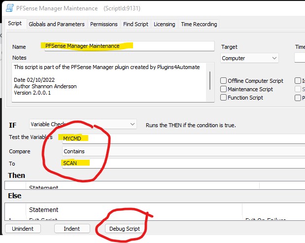

If your credentials worked in the above https request then try script in debug mode.
When you select debug mode it will ask for an agent to run on, select agent in same location/network then in the MYCMD area of the selection box to execute script, use "SCAN" so that it triggers the Then section of our script.
The script will attempt to collect all the data about that firewall.
You will find script in the
scripts -> maintenance -> pfSense Manager Maintenance
