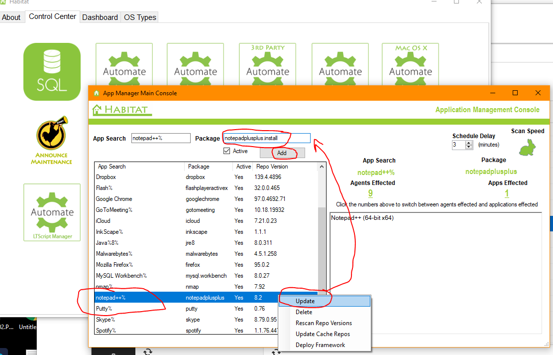

Ok figured it out...
What is happening is the Version of notepadplusplus pre 8.2 calls the notepadplusplus repo package.
In version 8.2 of the repo package it flips and looks for notepadplusplus.install on the repo.
Well of course its not there as it is a different package from just notpadplusplus.
In the image you can see I attempted a install, it failed eve though I had the package there. In the error it referenced notepadplusplus.install was not on repo, which is correct.
I then executed our repo caching command for that package and the retried install of same package. This time it went through without issues.
So this is not a plugin issue but a who ever built the package decided to flip packages.
To fix this issue you can change the package in the repo search to notepadplusplus.install and it should no longer use the notepadplusplus package which is now just a big redirect to notepadplusplus.install
Select notepadplusplus and right click to update, it will load above, edit the package field to include ".install" and select add.
On next run it will use that package to install notepade. Any install via cache issued will now use this package to install.

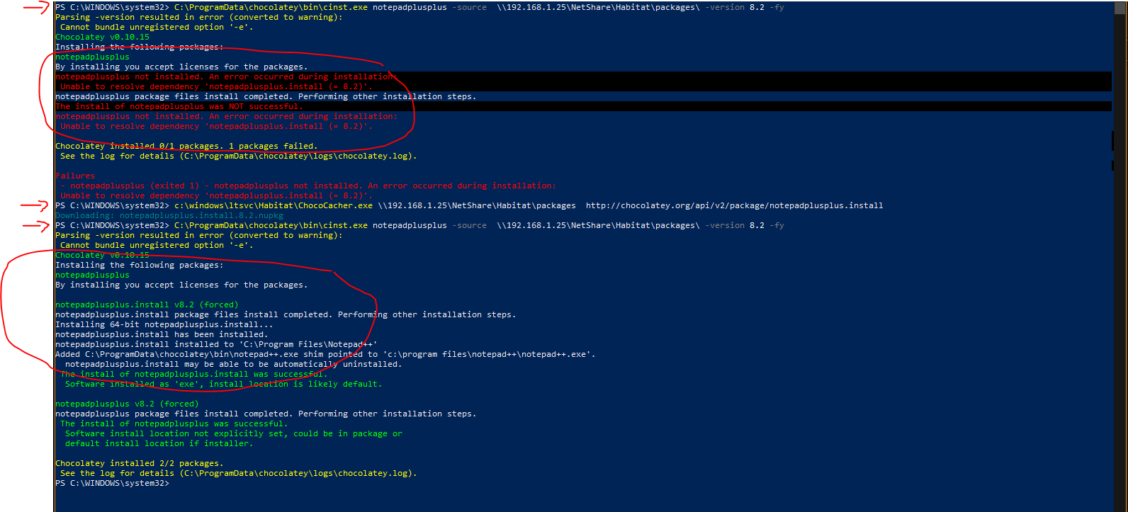

This is my error:

Now it is as follows:
Re: Newly 3rd party application manager not working correctly
Posted: Wed Jan 12, 2022 3:02 pm
Exactly!!!
Do you see it flip from notepadplusplus to notepadplusplus.install in the error logs when trying to install notepad++
This is the issue, Your local cache repo does not have notepadplusplus.install.8.2 but only notepadplusplus8.2
This issue is happening because the manager of this packaged decided that he didn't want to maintain 2 packages anymore and wrote a redirect into the notepadplusplus package. So how do you fix this oversight of the maintainer?
Add notepadplusplus.install package to your local repo leaving the notepadplusplus package there along side.
On the caching agent for that location open a command line and execute the following.
c:\windows\ltsvc\Habitat\ChocoCacher.exe \\SOL-S01\Site-Cache\Habitat\packages  http://chocolatey.org/api/v2/package/notepadplusplus.install/
This should download and push to cache location the other notepad++ installer. (notepadplusplus.install) Once completed and you can verify that new file exists on local cache then rerun the update as normal and watch the logs.
It will complete successfully.
This is just part 1, You still have X number of clients to go. To fix everyone now, just update the main plugin search area and change the notepad++ package from notepadplusplus to notepadplusplus.install
What will this do? It will force all caching agents on next cache to now download notepadplusplus.install.8.2 as a package available on the local repos caches. Then the agents when told to update notpad++ the next go around will have the new package available to them and the updates will complete successfully for everyone.

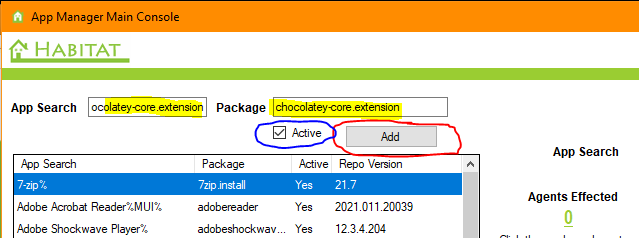

A prime example of a dependency "search" you should probably have.
Search = "chocolatey-core.extension"
Package = "chocolatey-core.extension"
This is not included in the default list provided but several packages expect the tools it provides to be there and so you may see a package fail if this is not present in cache.
Posted: Fri Jan 14, 2022 2:30 pm
Solving dependency issue with chocolatey-core.extension
