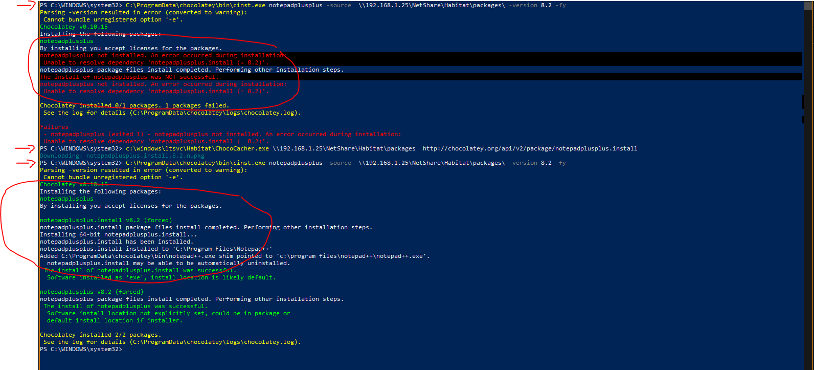

In the image you can see I attempted a install, it failed eve though I had the package there. In the error it referenced notepadplusplus.install was not on repo, which is correct.
I then executed our repo caching command for that package and the retried install of same package. This time it went through without issues.

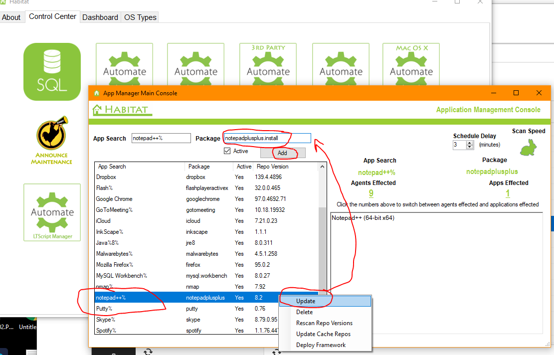

To fix this issue you can change the package in the repo search to notepadplusplus.install and it should no longer use the notepadplusplus package which is now just a big redirect to notepadplusplus.install
Select notepadplusplus and right click to update, it will load above, edit the package field to include ".install" and select add.
On next run it will use that package to install notepade. Any install via cache issued will now use this package to install.

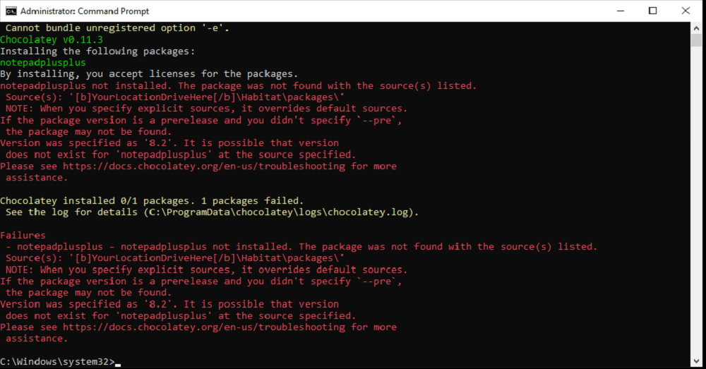

This is my error:
- error.png (138.11 KiB) Viewed 8010 times
Re: Newly 3rd party application manager not working correctly
You did see this? yes...
You were to edit that line changing the "YourLocationDriveHere" to your actual location drive setting as found in the location console.

Sorry, I looked over that.
Now it is as follows:

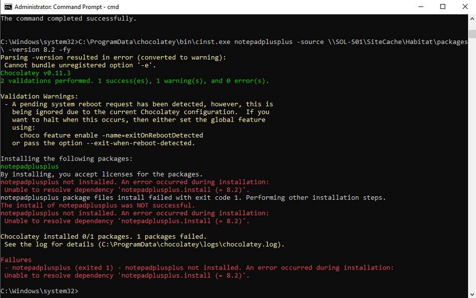

Do you see it flip from notepadplusplus to notepadplusplus.install in the error logs when trying to install notepad++
This is the issue, Your local cache repo does not have notepadplusplus.install.8.2 but only notepadplusplus8.2
This issue is happening because the manager of this packaged decided that he didn't want to maintain 2 packages anymore and wrote a redirect into the notepadplusplus package. So how do you fix this oversight of the maintainer?

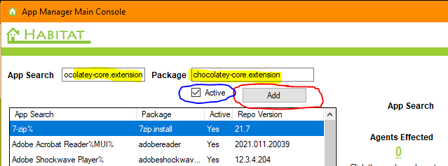

Solving dependency issue with chocolatey-core.extension
True, seems to have worked.
Is there a way to include this dependency into the framework?
