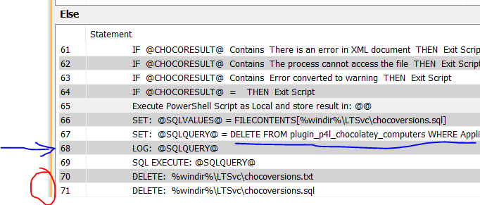

I am seeing an error every time the Maintenance script runs. Is this normal?
ERR an error occurred: Could not find file 'C:\WINDOWS\LTSvc\chocoversions.sql'.

bfrizie wrote: Tue Jan 19, 2021 6:32 pm The update seems to have resolved the problem.
I'm also seeing the same, is there any eta on the fix?
Re: Chocolatey Failing to deploy
Posted: Wed May 19, 2021 12:35 pm
Post your log entries here so we can see where it is. If your seeing the error from line 70-71 (red) then just before that function the SQLQuery is printed out to script log. (blue) Post that SQL query so we can see what it looks like. It maybe malformed indicating that the chocoversions.txt file was malformed. You will find all this information in the script logs under the agents console in Automate.
