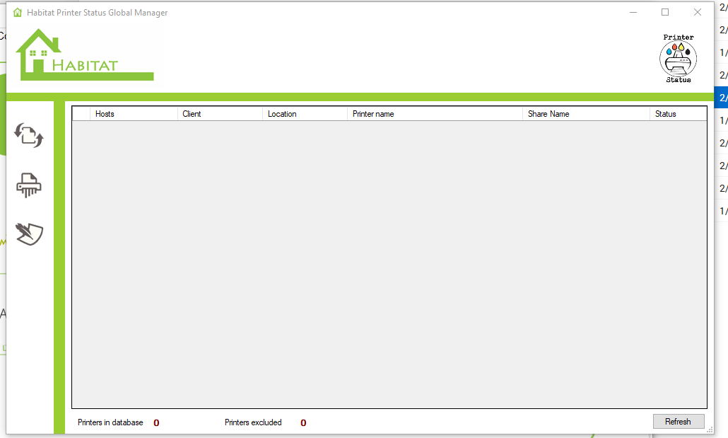

Hi Cubert, I'm struggling to get ANY data to show up in this plugin, everything that I've tried so far bring me no where. PrinterStatus is enabled globally within Habitat and enabled on each and every client, yet no printers appear at client level or within this PrinterStatus plugin itself.

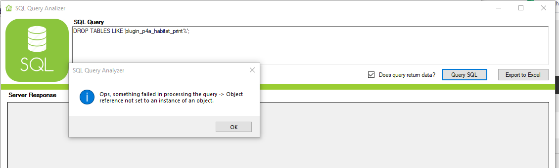

I've read your other forum posts and have tried manually scheduling the script to run on clients but that doesn't seem to work either? I've even tried to drop the tables and I've been able to do this successfully in the past (back with PatchRemedy) but now anytime I attempt to drop ANY table it doesn't appear to be working?

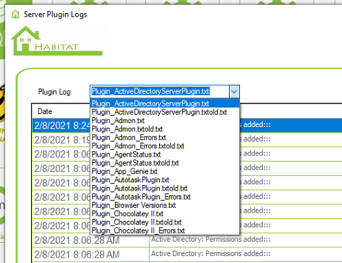

So I thought I'd try to use your 'Server Plugin Logs' so I can view the PrinterStatus Plugin logs, but I can't seem to get the it to show logs past 'Plugin_Chocolatey II_Errors.txt', in your screenshot you were able to scroll farther down to show all the logs, but I can't get that far. Any ideas or advise on what to do from here?

We found a minor typo in the database permissions access function and corrected it. If you were not a super admin in Automate then the view may not show up for you. This has been corrected in 1.0.0.62 due out in tonight's updates.
As for the SQL window error, this would be expected since the permissions above were off. the second part of the error is because you are executing a "DROP" and have the checkbox that data is returned set on. A DROP does not return any data back. so the error says that were data was expected there was none.
In SQL Analyzer try "Select * from computers" and check the box for data to be returned. See if you get the computers list back.
As for log files Chocolatey_ii is some old logs.... You might need to clear the logs folder of junk so that the scanner can read through all the good stuff and not get locked up on a old file.
Chocolatey_ii is now Chocolatey_For_LabTech and has been for several years.
