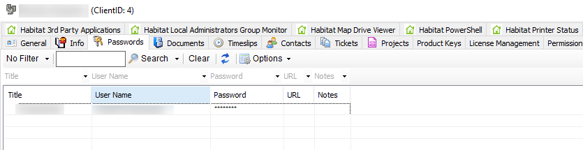

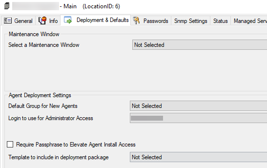

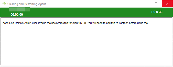

When attempting to restart an agent I am receiving the error message "There is no Domain Admin user listed in the passwords tab for the client ID [4]. You will need to add this to Labtech before using tool." I have a domain admin account assigned to the client and that account is tied to the location. Screenshots are attached.

- Habitat error restarting agent.png (7.84 KiB) Viewed 53216 times

The title must say "Domain Admin" the user can be anyone but the title of the account should be recognized as Domain Admin

Would it make sense for this plugin to use the value that's specified in the Location window as "Login to use for Administrator Access"? As it could be different per location (We had one or two customers where they acquired or merged with another customer, and thus had two different domains under one Client in Automate, just different Locations, and thus completely different domain admin accounts) (Future feature release upgrade)

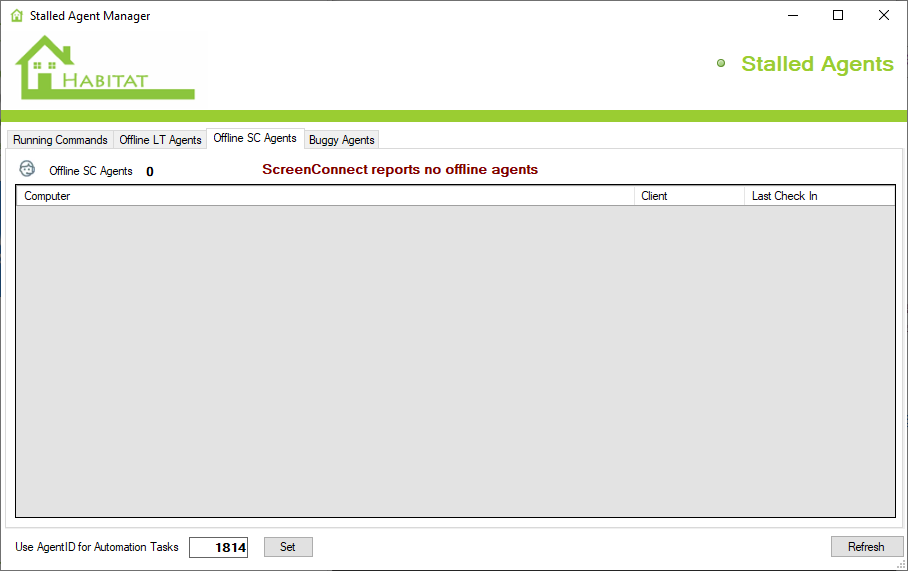

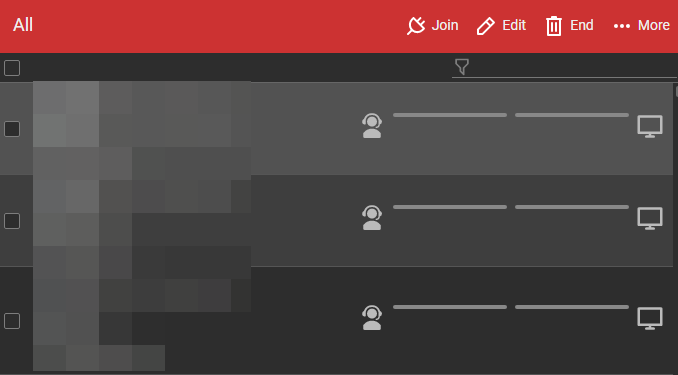

I'm still missing something in the configuration as it doesn't appear Automate and Control are communicating through the Stalled Agent Manager. When I select the Offline SC Agents tab it says ScreenConnect reports no offline agents, but when I log into Control there are multiple agents offline.

- Habitat SC offline agents.png (9.65 KiB) Viewed 48799 times
- Habitat SC reports no offline agents.png (23.75 KiB) Viewed 48799 times

That may be possible,
Can you confirm that the offline SC agents are not also offline as an Automate agent as well?
If Both SC and LT are shown as offline we do not list them as they are most likely really offline. The plugin attempts to show you agents that are online in one section but not the other.
See if this is the case or not.
Next to test if SC server requests are going through try to use SC to restart an LT agent. If there is an issue with access or the RMM+ plugin then it should report it during a run to restart LT services. Does this report successful or errors out?

We use this SQL query to see what agents show in LT database as SC offline and we use POSH to query The Connect Server to get a list of IDs that are offline. We place those ID's in to the SQL statement below to get a final list of agents that are online in LT but Offline in SC.
I am adding to the Stalled agents for next build a log that will start with Stalled Agents Connect Server reports ID's offline -> in "C:\ProgramData\LabTech Client\Logs" date_LTErrors.log. When you launch the stalled agents plugin it will log the return of SC query here. This will allow you to actually see what SC is returning to plugin. Plug that string of IDs into the SQL query below to see who matches up to an offline agent in LT and who does not.
You will need to wait for next update to Habitat for this log feature to be present. Shouldn't be but a few days tops.
SELECT a.ComputerID, c.name as Computer, b.Name as Client, c.LastContact FROM plugin_screenconnect_scinstalled a LEFT JOIN computers c on a.ComputerID = c.ComputerID LEFT JOIN clients b on c.ClientID = b.ClientID WHERE c.Name IS Not Null and c.LastContact > date_add(now(),interval -5 minute) and (a.SessionGUID IN ( SessionID's Retruned by POSH HERE ) or a.SessionGUID = '00000000-0000-0000-0000-000000000000')-
