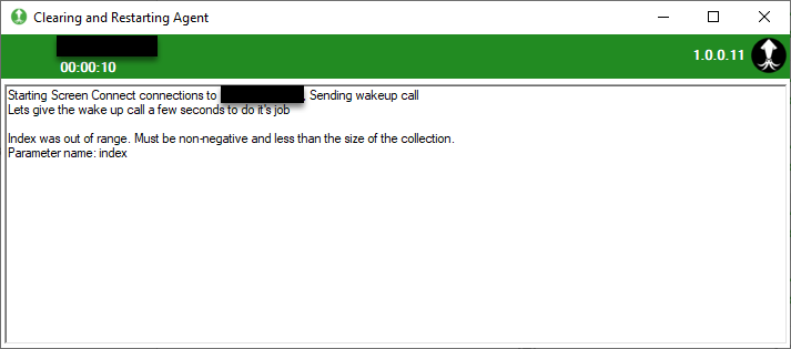

I too am experiencing the same issue.
Starting Screen Connect connections to [COMP_NAME], Sending wakeup call
Lets give the wake up call a few seconds to do it's job
Index was out of range. Must be non-negative and less than the size of the collection.
Parameter name: index
Stalled Agents version 1..0.0.11
RMM+ version 1.0.14
I have tried removing and re-installing RMM+ from Screen Connect and the Stalled Agents plugin from Automate. I have also reset the RMM+ Access code.

Re: Error running Stalled Agents
WHat version are you currently on?
For reference we are at build 1.0.0.12
When using SC to restart the LTagent services on an agent a call out to SC to wake up the agent. If agent is also offline in SC we would get a negative number back and that would fail to be saved as a whole number in the code segment and caused this failure.
1.0.0.12 resolved that error by handling it differently.
Now after receiving this text
you should of received a text line
Prepare to test agent.
Which leads me to believe you may be on 1.0.0.11 or earlier. Can you confirm your plugin build?

We are running Stalled Agent Detector 1.0.0.11 (and attempting via ScreenConnect, not RPC, for what it's worth). I see in my most recent email from your Shopify store that my download for StalledAgentsForLabTech-1.0.11.zip is available, and following the link provided in that email I'm seeing the same version number listed. I've not seen a mention of a newer version being released.
Yes, you need to upgrade to 1.0.0.12 and issues will resolve itself. Log into your account on plugins4automate.com, use the email account that the billing for plugin goes to. In your account info will be a link to manage subscriptions, each subscription has a download software link besides its description that you can use to get the latest build.
Oh Snap, I just checked the downloads and it had not been updated.. Not sure where that failure came from but we have the link updated now.
