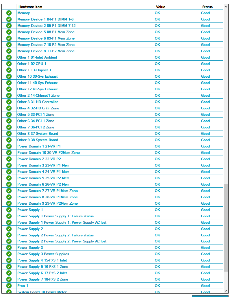

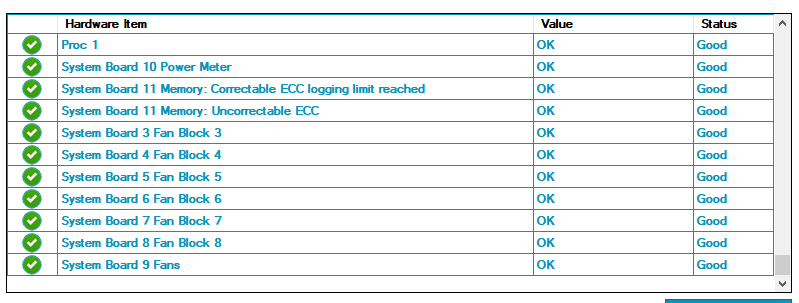

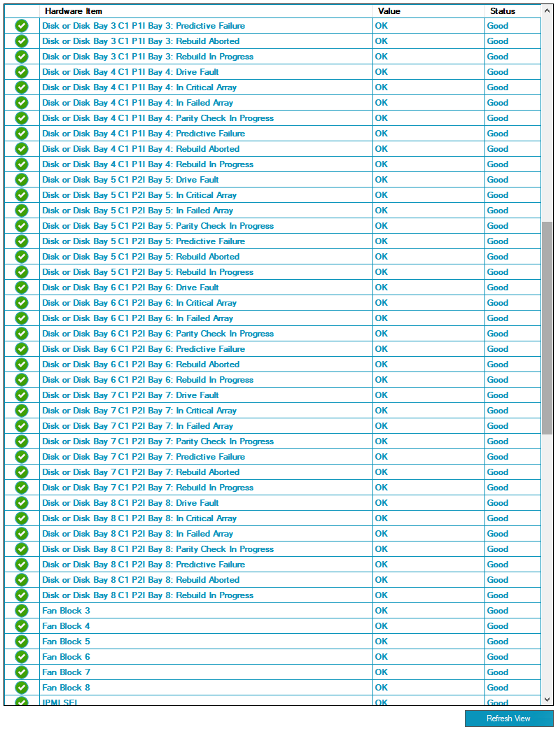

Attached is the RAW output and screen shots of the CIM data.
- check_esxi_hardware - raw output2.zip
- (2.54 KiB) Downloaded 546 times
- Screenshot 2022-10-13 122024.png (13.4 KiB) Viewed 68605 times
- Screenshot 2022-10-13 144225.png (7.37 KiB) Viewed 68605 times
- Screenshot 2022-10-13 144313.png (156.51 KiB) Viewed 68605 times
- Screenshot 2022-10-13 144333.png (163.46 KiB) Viewed 68605 times
- Screenshot 2022-10-13 144440.png (147.2 KiB) Viewed 68605 times
- Screenshot 2022-10-13 144509.png (39.03 KiB) Viewed 68605 times

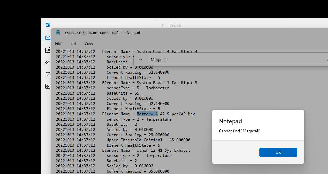

Re: How-To Manually Test Probes
I am not finding Megacell in your raw dump. Did you run that with the same vender?
I double checked and the screenshots from the ESX Health Monitor and raw script output are from the same server.

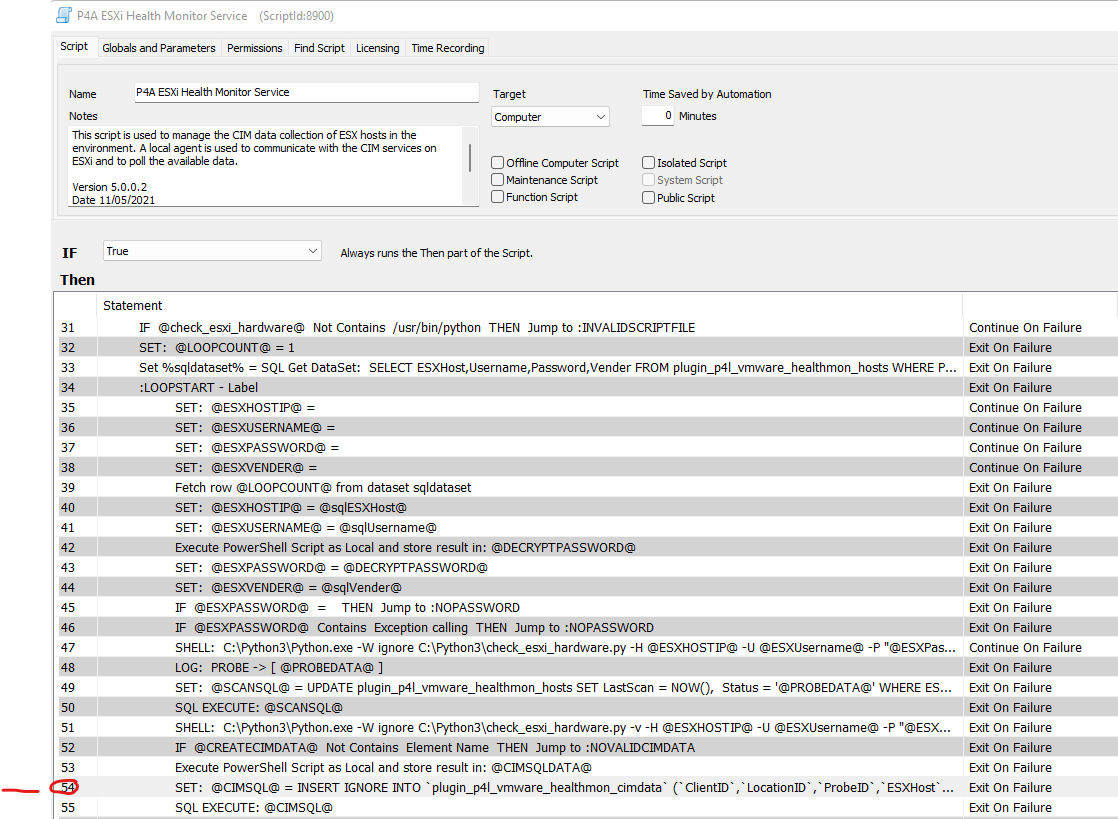

To fix this issue now within your plugin, open the scripts folder in control center and find the maintenance folder. Inside should be "P4A ESX Health Monitor" script. Some Automate hosts do not have a maintenance folder or folder is not consistent with Automate best standards, you may need to do a script search to find the title in your Automate host.
Open script and edit line number 54.
Replace the following SQL with the new SQL query.
New SQL code
We added a delete all records matching probeID/esxhostIP before inserting the new records. This will clear all old records out before saving new data. The ON DUPLICATE KEY is now redundant as there should never be a update at this point by I left it there anyhow, it will not cause issues with query.
See if this change has any effect on what data you see when the options are changed to different hardware types.

This is a plausible bug:
INSERT IGNORE INTO `plugin_p4l_vmware_healthmon_cimdata` (`ClientID`,`LocationID`,`ProbeID`,`ESXHost`,`CIM_Item`,`CIM_Value`) VALUES @CIMSQLDATA@ ON DUPLICATE KEY UPDATE CIM_Value=VALUES(CIM_Value)New SQL code
DELETE FROM `plugin_p4l_vmware_healthmon_cimdata` WHERE ProbeID= '%ComputerID%' and ESXHost='@ESXHOSTIP@' ;INSERT IGNORE INTO `plugin_p4l_vmware_healthmon_cimdata` (`ClientID`,`LocationID`,`ProbeID`,`ESXHost`,`CIM_Item`,`CIM_Value`) VALUES @CIMSQLDATA@ ON DUPLICATE KEY UPDATE CIM_Value=VALUES(CIM_Value)See if this change has any effect on what data you see when the options are changed to different hardware types.

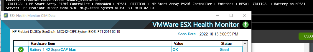

Hi Cubert,

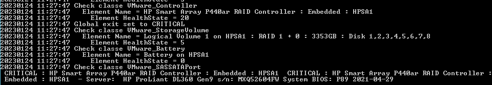

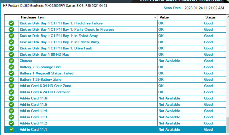

We tried your update and it worked for that one server so thanks for that but now we have 3 other HP Proliant servers that are not showing the proper battery status and controller status but when I run the script manually it does show the correct status.
What can we do to resolve this?

OK I am seeing HP report CIM value of 20 for the RAID controller. If RAID was in good standing that value should be "5" for HP meaning GOOD and operational.
The value 20 for HP was set to "Vender Reserved','Good" in our database which is what HP CIM chart showed for HP CIM DATA back when we first created mappings..
