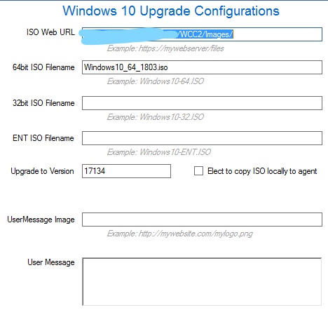

Also, But what is the process after setting the URL? Do we still need network share in location settings?? Does it download the full iso to each machine? If so where does it download to?

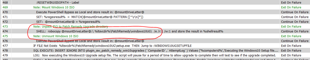

Here is a excerpt from our script showing what and where we are creating files.

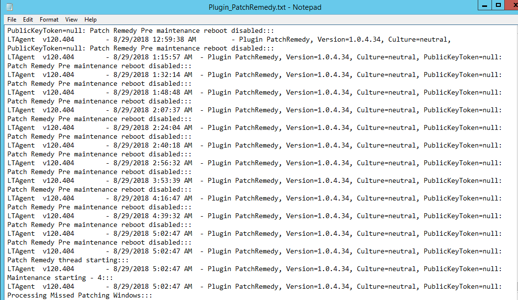

As for the logs , that would be the ones. First off need to know what's in the error logs. Then we need to look at the time frames for the scheduled run and see what PR was doing during that time.

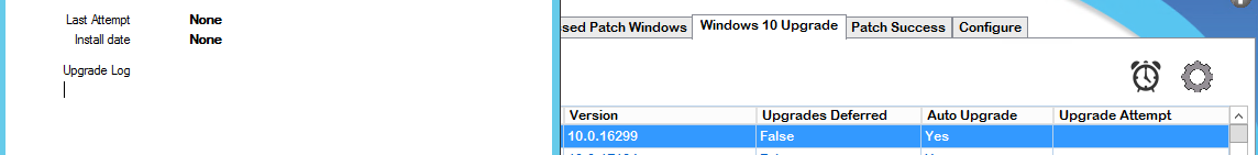

Stated before, I upgraded the iso to newest version. I ran another auto upgrade on a few machines for 8/29/18 at 1 am.
I reset the upgrade logs on these few machines. The auto upgrade column said yes. I scheduled the upgrade for Wednesday at 1 am. Again , no indication the upgrade started. Attached is the logs in plugin_patchremedy.txt for time frame. No commands or scrips ran in the console. If there are additional logs i can gather, let me know where and how to gather those logs
